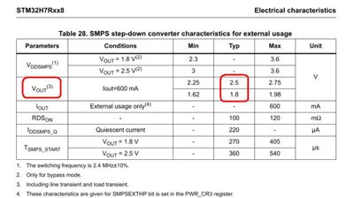

Can anybody explain how it is possible to power VCORE directly from SMPS output?
I see that SMPS have only two possible output voltages, 1.8V and 2.5V:
But VCORE accepts absolute maximum of 1.4V.
So how it is possible with LDO bypassed?
Best Regards

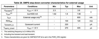

‎2025-05-14 7:03 AM
For this mode in the STM32H7RS, it's not supported. Therefore, the phrase mentioned in Table 44: "SMPS step-down converter enabled at 1.35 V, may be used to supply the LDO" will be updated in the next release.
Note: You need to update your datasheet document because I noticed there is a difference between Table 28 SMPS step-down converter characteristics for external usage which exists on the website and your version.
Your screenshot:
Which exists on the website:
Thank you.
