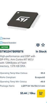

Hi ,
We can may be explore the B0 variant on our e-Store .
