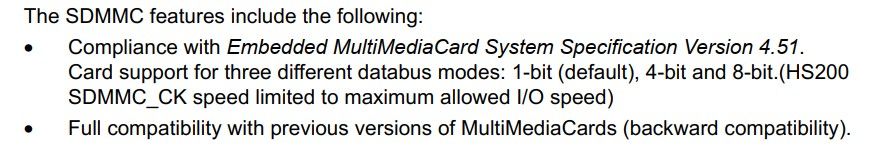

I read through the AN5200. Again. My question is: Do I need to configure that IDMA/MDMA is used or does the HAL layer do the magic for me?
Do I need to touch the MDMA configuration to provide a channel in the .ioc file? I don't see this being done in the examples, so I'm guessing no.
I'm looking at the examples for STM32H745I-DISCO/Examples/MMC/MMC_ReadWrite_DMA and I don't see any configuration for the MDMA, all I see are
HAL_MMC_WriteBlocks_DMA(arguments);
HAL_MMC_ReadBlocks_DMA(arguments);
and it just works apparently.
Am I missing something here with the configuration?
@Imen DAHMEN​
TOlli
Senior
And I went back again into the HAL driver.
Does the HAL driver actually support 4 bit wide bus or not?

Check line 87: why is this value forced to 1B? Do I need to rewrite the HAL driver to get 4B support, or is this something ST is going to provide at some point?
Best regards
One bit mode is forced as eMMC starts in one bit mode. You can switch to 4- or 8- bit mode afterwards. CubeMX will generate code that does this for you, although the eMMC support with HAL is not great.
Hi TDK,
I noticed that the init sequence is done correctly at 400kHz with 1B.
But afterwards, that code referenced above is the last thing that is called before entering normal operation. So I assume that the 1B mode is forced in fact. Or at least I can't find anything that would suggest otherwise.
Maybe I should call the configuration function again myself.
Maybe this is just a work in progress and I need to do this by myself.
Thanks.
