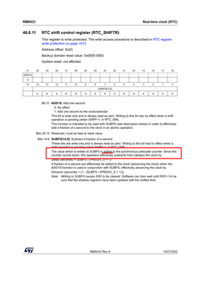

> I expect that it should be lower than 100 but close (not higher)
Why would you expect that?
Note, that as consequence of shift, SSR can even get higher than the synchronous prescaler - description of SSR register warns for that.

Dear  @waclawek.jan ,
thanks for response. Yes of course I have omitted this, I of-course read TRM but I must have been so blinded! Thanks for mentioning this, this is clear for me. But I have follow up problem with adjusting RTC:

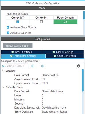

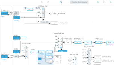

(2) Firstly I tested with HSE clock and it was annoying me there... when selecting HSE for RTC clock ( 25 Mhz divided by 25 to make 1000kHz RTC clock source with async = 99 and sync 9999 (or tested also with async=124 and async=7999) I have still errors (after writing to RTC->SHIFTR it looks that subseconds is not tuned and their are hopping between hundred msec in their full range for example +172; +544; +260; +186; -271; -268). It looks that there could be something wrong with prescallers settings here.

Are you sure you are running from a crystal oscillator in the HSE case?
What hardware is this, exactly? What is the HSE arrangement?
I suppose that it is running from 25 MHz :) I verified the HSE clock by scope using MCO output and is working fine.
I am using NUCLEO H755 board https://www.st.com/en/evaluation-tools/nucleo-h755zi-q.html
I solder xtal, capacitors and change SBxx resistors to adapt HSE instead of default clock 8MHz - STLK_MCO from STLINK. All periferials working normally, and ALARM on RTC produce 1sec interrupts. I am attaching both IOC files, and screenshot for quick verify
Radim

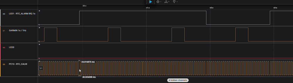

Thanks for your comments. Do you think that this is not related to fact, that I don't have PREDIV_S non-zero multiple of 256 as noted in 49.3.16 Calibration clock output in TRM document:
"When COSEL is set and “PREDIV_S+1” is a non-zero multiple of 256 (i.e: PREDIV_S[7:0] =
0xFF), the RTC_CALIB frequency is fRTCCLK/(256 * (PREDIV_A+1)). This corresponds to a
calibration output at 1 Hz for prescaler default values (PREDIV_A = Ox7F, PREDIV_S =
0xFF), with an RTCCLK frequency at 32.768 kHz."
But I have here 30 pulses in 1 seconds with period * 32 ms + (at end one which is 16 ms positive pulse + 24 ms pause ) which correspond to TRM.
But I don't know if this could also affect SHIFTR. What do you think ?
Regards Radim
waclawek.jan
At this point, I'm confused what are you actually doing.
I thought you are reading out time including SSR to compare to SNTP timestamps; but now you brought out RTC_CALIB output. So which one is it?
The calibration output is probably an extra issue in itself.
