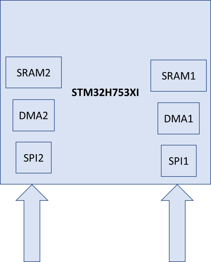

STM32H753XI. When 2 DMAs are working and writing data from SPI1/2 to SRAM1/2 the received data has errors. When only one DMA is working the received data has no errors. Why?
nHasi.1
I am using STM32h753XI.
The MCU uses 2 SPI channels (SPI1 and SPI2) in slave receive mode.
The MCU uses 2 DMAs channels (DMA1 stream0 and DMA2 stream0) to read the data from SPI1 and SPI2 and write it to SRAM1 and SRAM2 respectively.
The input SPI sclk is about 50 MHz
The 2 DMAs work continuously (circular mode).
The 2 DMAs FIFO is enabled.
The SPIs data word length is 32 bits.
The DMAs data width is 32 bits.
MCU Data Cache is disabled.
When the 2 DMAs work together the received data has few errors (1-10 in 10 seconds).
It sometimes seems like the data from SRAM1 had "leaked" to SRAM2 (I am not sure).
When I disable one of the DMA channels the received data has no errors at all.
What can be the reason for the data corruption when the 2 DMAs works simultaneously?

Try show some code too.
Speed, considering decimation, doesn't seem unduly fast for multiple memories, or multiple controllers.
Shouldn't be cache coherency if they are off, but that will make everything very slow.
What stepping / version of the core is in this part?
Any Errata look like this?

  • The buffers are defined as global and are aligned;
__attribute__((section(".sram1"))) volatile  ALIGN_32BYTES(uint32_t buff_sram1[32768]); /*buffer for 1st spi channel. located in SRAM1 (limit size 128KB <--> 32KW32)*/
__attribute__((section(".sram2"))) volatile  ALIGN_32BYTES(uint32_t buff_sram2[32768]); /*buffer for 2nd spi channel. located in SRAM2 (limit size 128KB <--> 32KW32)*/
  • I tried to reduce the compiler optimization for 0. There is no change
  • Tesla. STM32H753XIH6 version V. The is no relevant issue according to the errata.
Any more ideas?

just...i would try:
use 2 ch on same DMA ; ie. DMA1 stream0 and DMA1 stream1 .
waclawek.jan
How do you know? How do you test it?
First make sure you know what da​ta you expect to see and that you observe them correctly.
JW​
