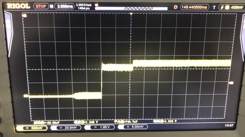

Our application is to use STM32H7 to finish the communication to FPGA/LAN9252/PHY/SDRAM. The power supply of VDD3V3 is generated by an LDO with Tr = 2.4ms.

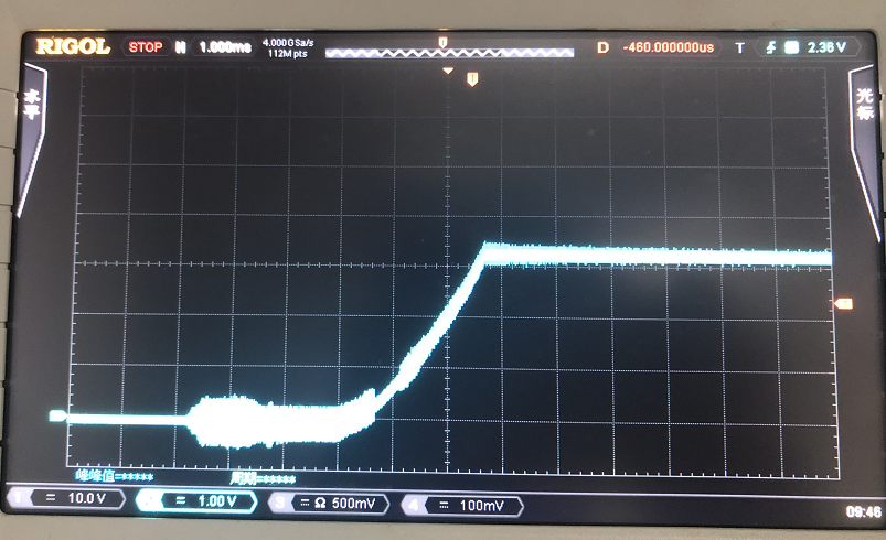

  2. ​VCAP1 & VCAP2 pins are connected to GND via two 2.2uF low ESR capacitors. Vvcap = 1.2V, but the rising edge has a step (find details in attached figure 1).
  3. BOOT0 is connected to GND via 100k pull-down, and BOOT1 is float.
Figure 1. Vvcap rising edge
Figure 2. VDD3V3 rising edge

A​s it is effecting multiple boards I would double check the netlist make sure you don't have any odd or misnamed nets causing islands, especially in grounds, ie hidden pins in symbols, separate RF, Analogue and Digital grounds which are all bonded at some point.
Also inspect unpopulated boards for issues with metalization/etch, and do continuity testing while flexing.​
