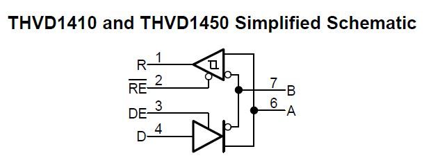

I'm using the UART (USART5) with RS485 and I have enabled the read to be on also when sending. I need to read back the data that was sent to see if it is correct. The problem is, that I do not receive what was sent. But if I send the same data from other device (without changing any code), I will receive the data. So the receive works, but not the same time with sending.

@CharlieMangold In your schematic, you only have a single signal, so TX and RX can't be active at the same time. This is like using UART in one-line mode where a single pin is used for both TX and RX.
Full-duplex 485 transceivers can have both directions active at the same time and has two signals, one for TX and a separate one for RX.

Because the signal on bus doesn’t have any direction, the receiver in RS485 will send it of course back if RE is enabled. It doesn’t matter who is sending the data. That is why you normally disable the receiver when you send your data so that you won’t receive the sent data. Now I want to read it back to know that my RS485 receiver is working and that there was no collision with other device sending at the same time. The HW I have is like yours. And as I have many times already written, I can see the data on RX line with logic analyzer so HW is working as it should. Only the MCU doesn’t want to see it.

Looking at the simplified schematic of our chip I would not have guessed that the transmitted data would make it back to the receive line. I get that you keep saying that you see data being received but honestly I thought maybe you were mistaken as you showed no O-scope traces(it's hard to tell experience levels here.)
If the data is making it there then it must be a configuration issue. You could try turning off the FIFO's to simplify things and as @TDK mentioned examine all the USART config registers to insure there is not some bit set incorrectly. If you have debug capability configure the USART Rx interrupt to fire and set a break point there.
