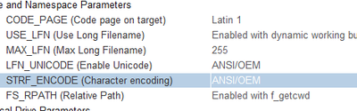

hi,
I was trying to open Jpeg files from SD card and show them on LCD. LCD works, SDMMC works, I open the File System, I can read if its FAT32, I can read free space etc. But When I want to open a file or create a file on system it fails.
* I always get FR_NO_FILE when I want to read a file.
* There is no error when I want to create a file and write something in it. But When I put the SD on PC There is no such file in it.
* Also I cannot read the label of the SDCard.
* Dcache disable & enable does not change the result.
Here is my Code sample :
** I've tried "0:" lately but it does not changed anything. What should I do ?

‎2025-01-25 12:48 PM
I think I've found the problem. I've turn to ANSI/OEM now. Everything works :D
