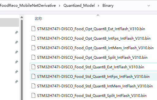

0693W00000aJ09tQAC.jpg*Using FP-AI-Vision1 Pack

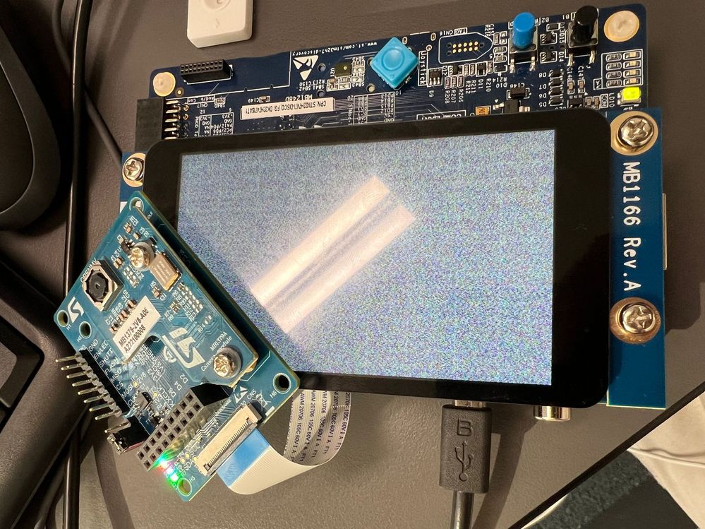

import the binary webcam, the screen is black.
import the people detection binary, the screen is a mess.
No camera picture.
While import the Tutti Frutti demo, it can normally run.

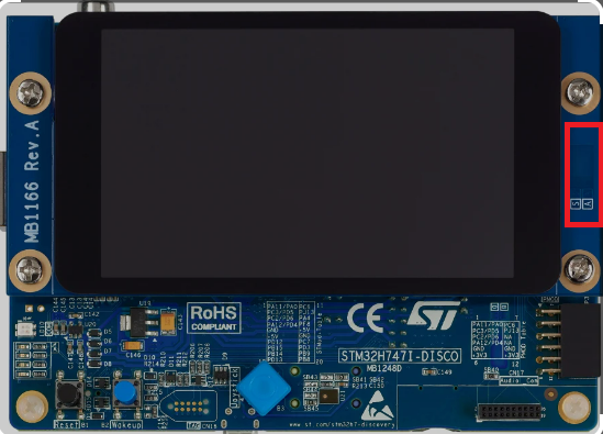

Which MB1166 Rev.A revision are you Using? A01, A03...?
You can find the MB1166 revision as shown in the below figure.

Hi, excuse me
How's the issue going?​I'm using these binaries and all of them shows mess on the screen

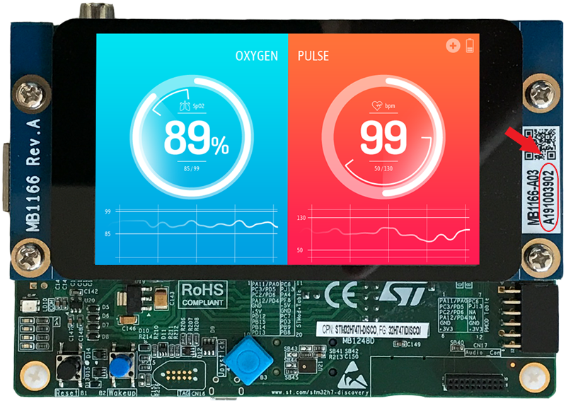

could you please give me the S/N (serial number) for your LCD , you can find how identify your SN on the picture below ,
_legacyfs_online_stmicro_images_0693W00000bjHktQAE.pngThank you
Az.21
I've commented in another questionFeed Detail (st.com)
The best comment is from me, I've uploaded some pictures about this issue.
(The default screen serial num is A225300780 with a QR code on right.
The new screen is A214500023 without QR code.)
