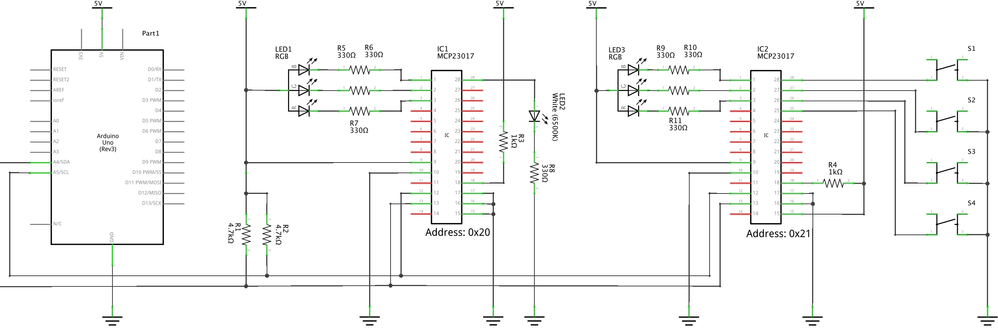

Hello!
I am trying to connect 8 mcp23017 gpio extenders daisy chained to stm32 but I am having difficulty testing the validity of the ports. I configured the extender and set up the pins to be output pins but when I send the data to write active high to all the ports of the extender, I get no output... what I might be missing here? Is there anything I am fundamentally doing wrong? The extender I am testing the ports with the code below has address 0 (and the base address is 0x20) I would appreciate any kind of help/tips! I included my code below:
thank you!

waclawek.jan
June 2, 2023
> daisy chained
How? I2C is a bus, you should put all ICs in parallel.
Observe waveforms on the I2C lines using oscilloscope/LA.

yes - sorry they are in parallel (I made a mistake with my explanation) but I can't even work with one slave right now... am I sending the signals wrong from what you can see? should I be doing something else to configure the devices?

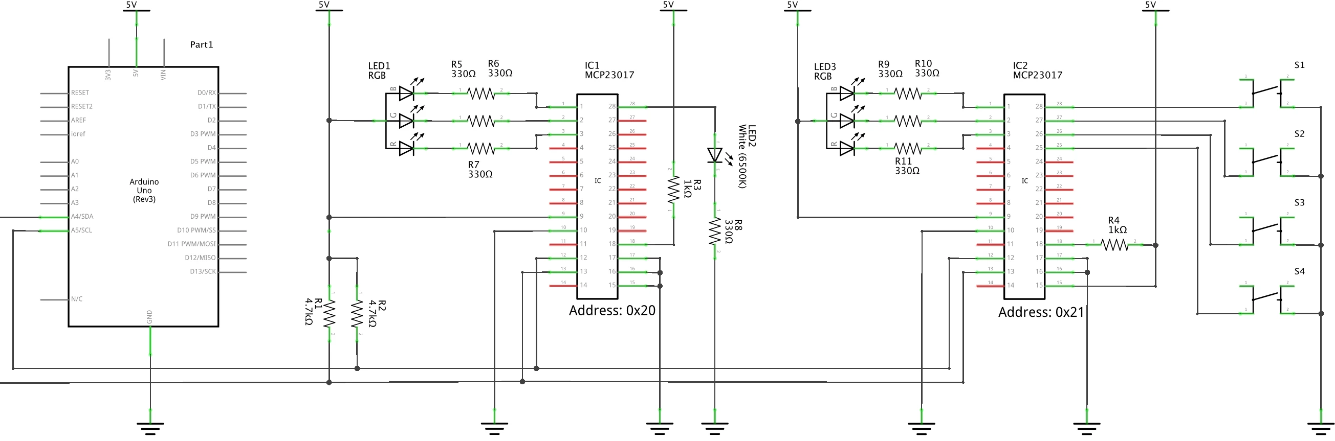

update: the error is caused by this line specifically:
~code from the driver:
/* Send Slave Address and Memory Address */
  if (I2C_RequestMemoryWrite(hi2c, DevAddress, MemAddress, MemAddSize, Timeout, tickstart) != HAL_OK)
   return HAL_ERROR;
so it's not even communicating properly as a slave. my set-up Is very similar to this one below (I only have one led hooked up to one of the three mcp extenders I have... I don't think it's the connections - I think I am not sending the signals properly/configuring things the right way. I am very new to stm32 so thank you for still helping me out!

waclawek.jan
June 2, 2023
I2C master can be also relatively easily bit-banged.
