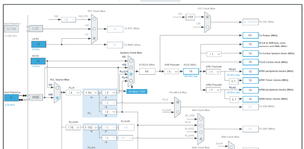

0693W00000bhIjYQAU.pngAnd this is the ioc setting(including clock configuration):
[I2C]
standard mode with 100kHz
PB8 for SCL and PB9 for SDA, both pin set as open drain and pull-up.
[RCC]
set HSE to Crystal/Ceramic Resonator

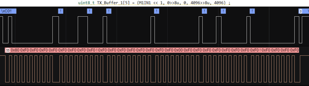

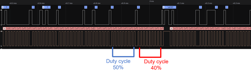

I use the logic analyzer, and the SDA line shows what I trasmit is correct

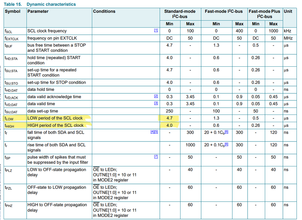

***Worth mentionong, I found that at the SCL line, some duty cycle are 50%, and some are40%, don’t know if it make the i2c not working…
100kHz = 10us, refer to the form, the duty cycle should be between 40%~53% (?)

Why do you use "M1IN1 << 1" as the register address in buffer 1, and likewise shifting by 1 in buffer 2 and 3? Presuming LED0_ON_L is defined as 6, then you are sending 12 (0x0c) as the register address (as shown in the logic analyzer data). That is LED1_OFF_L, probably not what you intend.

I'm curious about how to read the logic analyzer data.
I read SDA 0 or 1 when SCL in evert HIGH pulse. so the result as below, 1~7bit is the data, the 8th bit (red one) for write/read, and the 9th bit (green one) for ACK/NACK.
Because during the 9th high pulse of SCL, SDA is LOW, so it's ACK.
And, 0x06 = 6 in decimal = 110 in binary
Is that right?

@Bob S​ you're right. I don't need to shift one bit left for control register.
another mistake for me is that the write value for 4096, sould be 4096 fiirst, and then 4096>>8u.

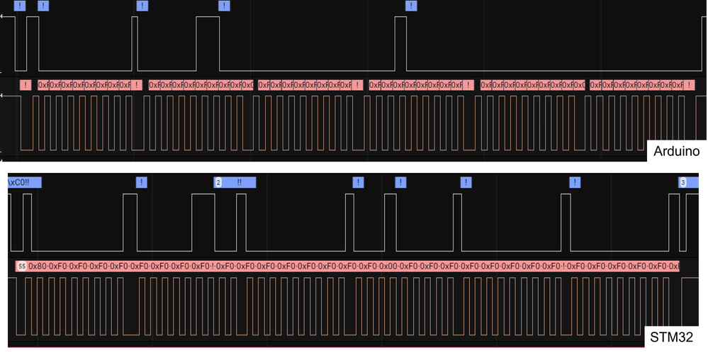

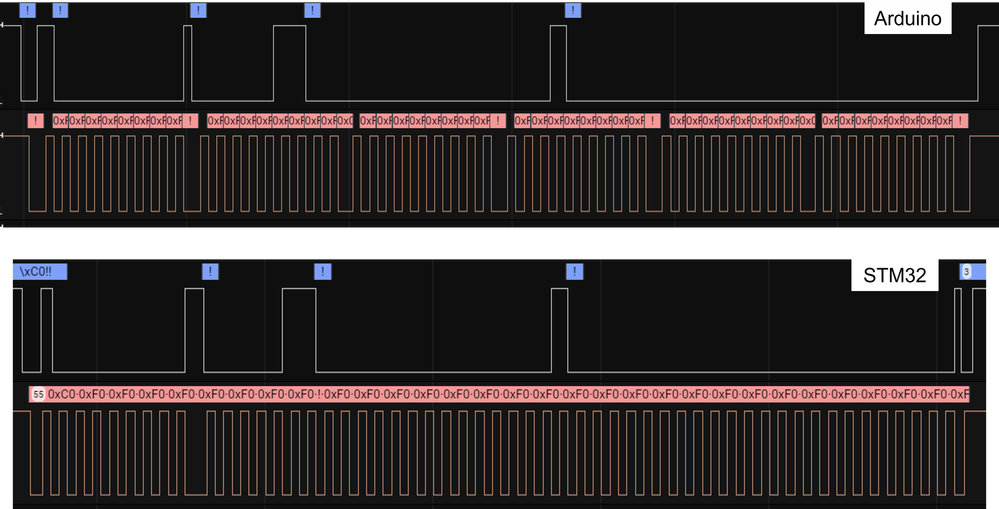

I fix the two mistakes, and comapre the logic analyzer result with STM32 and arduino. Here is the different.
use HAL_I2C_Master_Transmit() in STM32 v.s. arduino
​SDA line got some other HIGH signal between every byte0693W00000bhKbQQAU.png
use HAL_I2C_Mem_Write() (recommend from @AScha.3​  ) in STM32 v.s. arduino
SDA line data looks ok
but the problem is SCL line, there is no gap between every 9bit
There doesn't NEED to be a gap between each byte. A gap appears only then the master is not quite ready to send the next byte after the ACK cycle. As long as the data line is valid on the rising clock edge, all is fine.

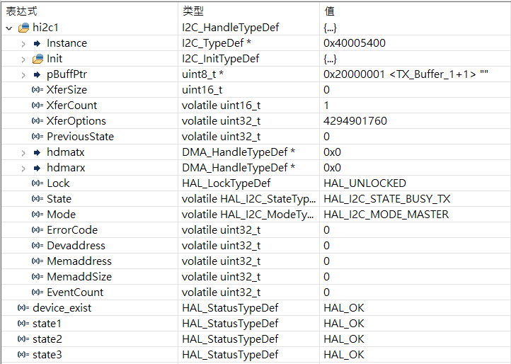

Here is my latest code. I want to drive a motor rotate in one direction continuously, and the motor connect to M1 on the board.
In the live expression of STM32CubeIDE, I can see the I2C1 is set, and the pBuffPtr in keep showing the value I transmit, and the transmit state that the function is all HAL_OK, also check the device exist or not by "IsDeviceReady" function, and it exists. but the motor doesn't do anything...
