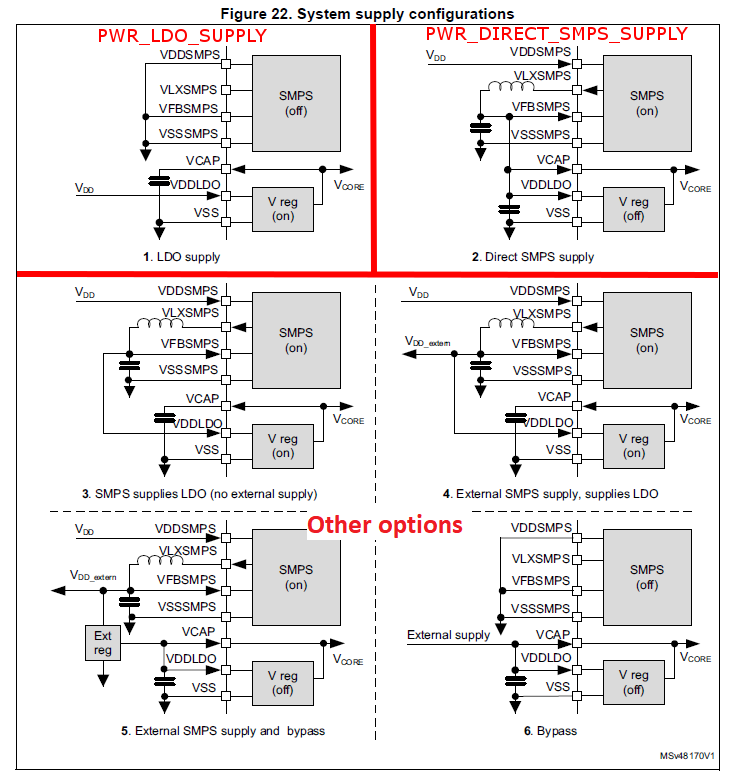

There are two possible root causes for this issue. The first root cause is more probable and is related to power supply misconfiguration. The second root cause is related to the configuration of the boot process in the option bytes.
1. Possible root cause one (power supply misconfiguration)
This applies to all STM32H7 devices with configurable internal SMPS step-down.
This is most probably related to power-supply configuration. STM32H7 devices with an embedded step-down converter offer different power-supply schemes. The selected configuration depends on external components.
This configuration can be set only once after a power-on reset. Choosing the wrong configuration leads to MCU lock-up. The configuration is done with the following line in the HAL library (usually placed in the SystemClock_Config function):
HAL_PWREx_ConfigSupply(...);
Most of the boards have the supply directly from SMPS (if available in MCU), which requires the above function to be called with PWR_DIRECT_SMPS_SUPPLY parameter. But STM32CubeMX generated projects might have the PWR_LDO_SUPPLY option by default. This parameter can be configured directly in STM32CubeMX, under RCC, and it sets the appropriate project macro to be used during compilation.
Since the configuration can be changed only once after power-on reset, the issue might manifest itself after the next power cycle.
Below is a diagram from a reference manual showing different hardware configurations for the power supply.
The MCU contains a protection mechanism that prevents setting higher voltage from internal SMPS to VCORE (1.8 or 2.5 V). This should prevent damaging the MCU due to misconfiguration.

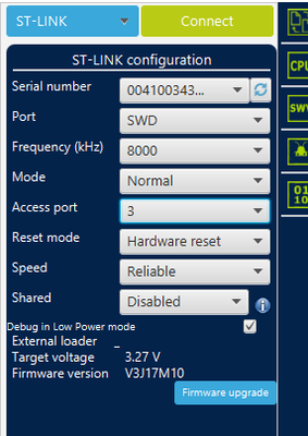

3. Possible root cause two (Cortex®-M7 boot disabled)
This applies to all STM32H7 devices with dual-core feature.
Other possibility is that the option bytes are configured in a way that only Cortex®-M4 boots after reset (BOOT_CM7/BCM7=0, BOOT_CM4/BCM4=1). Then you need to connect the debugger to Access port 3 (Cortex®-M4), instead of Access port 0 (Cortex®-M7).
For STM32CubeProgrammer versions 2.2.0 and older this does not seem to work. Please use a recent STM32CubeProgrammer version.

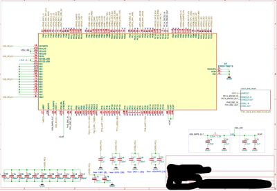

Oct 31, 2025 16:16 UTC
This appears to be the problem on our boards, we are using LDO yet the default CubeMX setup for the H725 was for SMPS.
Our attempts to recover via solution #1 haven't succeeded yet though, either no target found or CMD error.
Should the nRST on STLINK probe remain connected in parallel ? (We've tried it both ways)
software or hardware reset in CubeMX ?
would clock speed make a difference ? (so far just tried default 4000)
Adam BERLINGER
Nov 3, 2025 08:15 UTC
Hello @niallp
The NRST button should be connected in parallel to debug interface, just like it is done on ST evaluation boards.
In STM32CubeProgrammer settings, the reset mode should be set to "Hardware reset" and mode should be set to "Connect under reset".
I don't think the clock speed should make much difference, but usually lower speed is more stable/reliable.

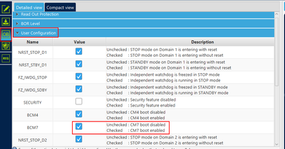

Jan 6, 2026 01:04 UTC
I somehow managed to brick my Nucleo STM32H755 board. Although I can connect to the second core (access port 3), I can't connect to port 0. I think I disabled the M7 core by accident through option bytes. Unfortunately, if I try to restore factory reset of the option bytes, I am getting an error "Device 0x450 not supported for factory reset operation" (while connected to the M4 core using the STM32CubeProgrammer talking to the on-board ST Link interface).
I've tried rebooting while holding BOOT0 high, but that seems to have no effect (or perhaps I don't quite understand the right sequence).
Adam BERLINGER
Jan 6, 2026 09:05 UTC
Hello @etl17 ,
This issue should be possible to solve with the STM32CubeProgrammer (v2.21, but older should work as well) and setting the BCM7 bit. I tested and used following configuration to connect to Nucleo-H755 board while Cortex-M7 is disabled.
Then I can change the option bit back in option bytes:
As you mention, the factory reset is not supported for STM32H755. Maybe there could be situations where the factory reset is not possible, or setting the option bytes to default could lead to issues.
