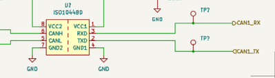

julian_bischof
Thanks for the quick response!
The CAN interface looks like as following:
The CAN Bus configuration is supposed to be in silent mode, so that my logging device only listens to the bus.
The settings shown below unfortunately did not solve my interrupt problem.

 "listens to the bus": That's why you need to share the schematics as it was requested and as you did.
