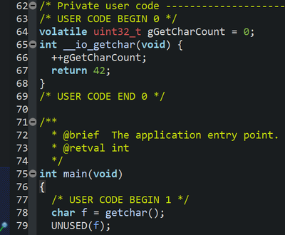

With this code:
We get this after one getchar() call:
You can set the input to unbuffered to get only a single call.
setvbuf(stdin, NULL, _IONBF, 0);
4 REPLIES 4
Input is buffered, so when you request a char, it reads a large number of inputs (in this case, 1024), before giving you the one you requested.
With this code:
