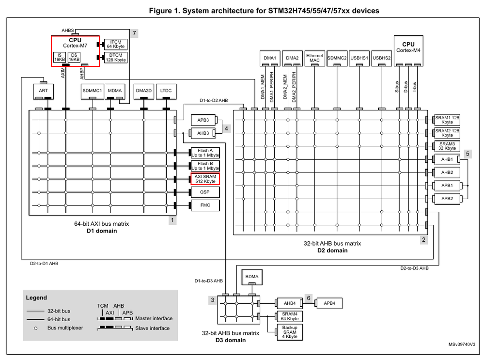

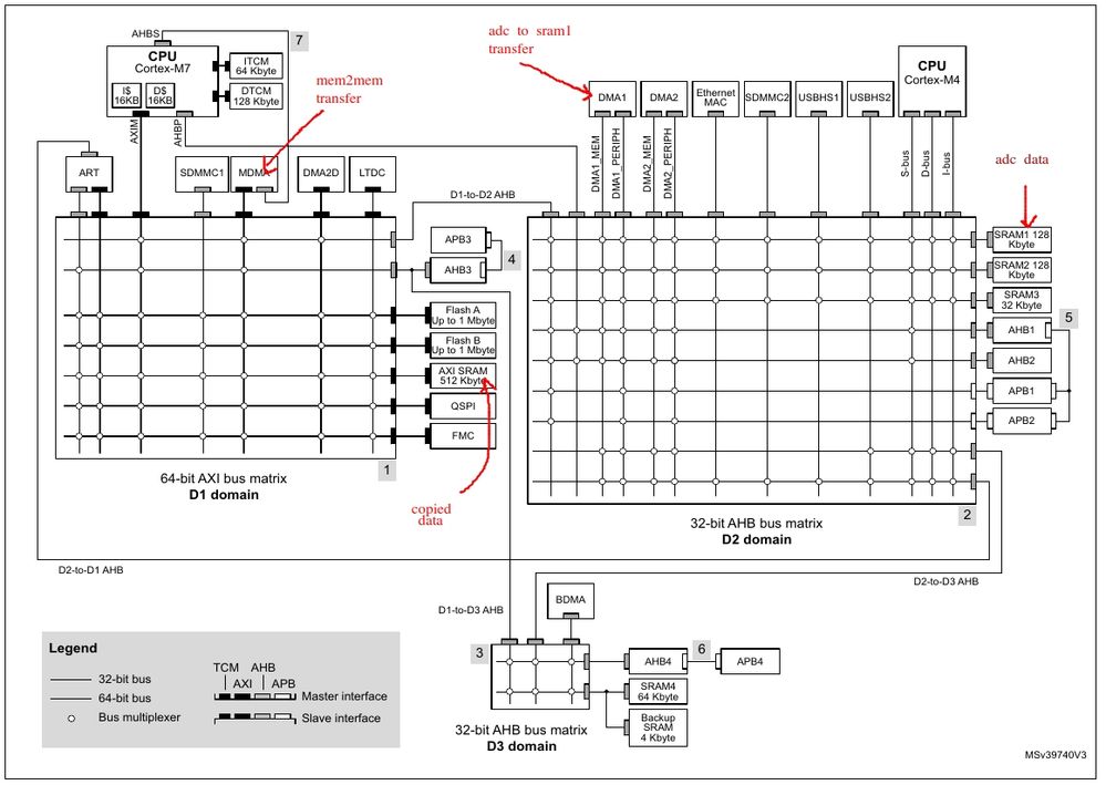

Here's my plan for the memory usage, do you see pitfalls?
My concern is the d1-to-d2 bridge, but I don't think it could be avoided.

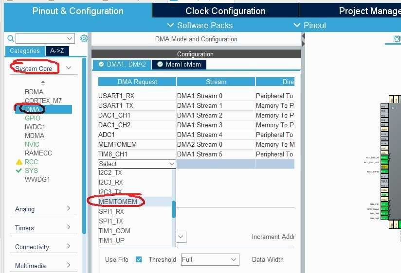

For mem2mem and others I use STM32CubeIDE generated code and it works perfectly fine. You can add MEM2MEM from the menu from the left side of PIN configurator:
System Core → DMA → ADD → in "select" drop-down list chose MEMTOMEM
I have used WORD (4 byte) data width, so dataLength of HAL_DMA_Start_IT is divided by 4: sizeof(someBuffer)/2/4. Division by 2 is because it is half complete interrupt, and only half of data is ready for transfer. I have not used mem2mem with BDMA and cache. If something does not work I would try to disable cache and test BDMA mem2mem separately by filling input buffer with 01 02 03 04 and copying it to some zeroed memory and see if it works.

The cache maintenance is not correct.
