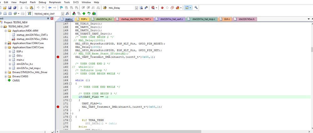

I am using stm32h745zi controller in my custom board. I want to use uart in DMA mode.
When i send data through uart i got an interrupt only for first time. How can i get Interrupt everytime. and how to use uart DMA in both cores(Both tx and Rx).

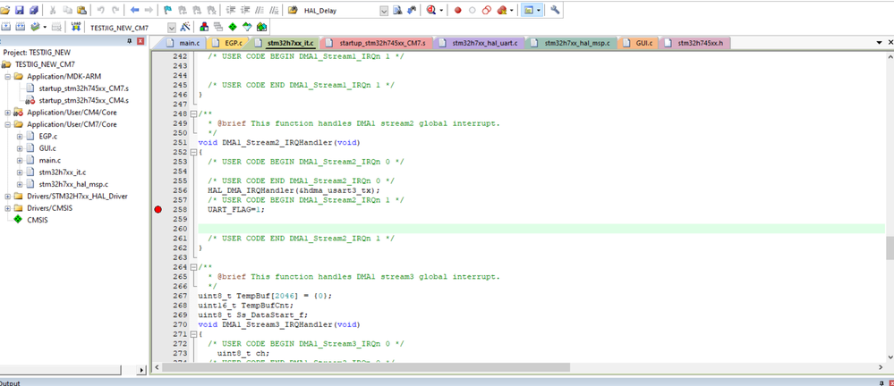

when i send data using HAL_UART_Transmit_DMA() i am getting interrupt for the first time but not for everytime .
you can see my code in below attachment.

You can't cast a character to a pointer like that.
