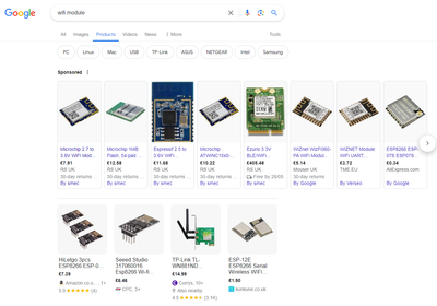

There are many WiFi modules available on the market, with a variety of standard interfaces - UART, SPI, etc ..
eg, only yesterday:
