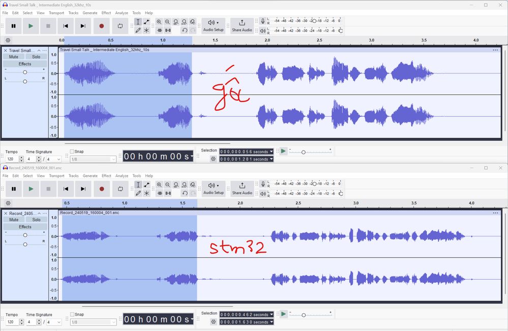

I have wrote software for recording audio from line in to wav file for STM32H745 discovery board.
But output file is distortion (original file and output file is in attachment)
Input file and output file is the same sample rate (32khz, 16 bit, 2 channel)
I have compared 2 file in audacity in following picture.
Could anyone have experiment to fix this problem ?

AScha.3
Mickey Mouse speaking ... :)
So you have mixed up the data , maybe 16b -> 2x 8b -> 2x16b , producing like double speed audio.
Check, how you handle the data flow.

No.
First you should tell, what and how you do :
- data from..to .. (onboard codec ? to sd-card ?)
- copy from STM bsp example  or your own ?
- data flow: input (2x 16b stereo ?) to ..? sd-card...or ? and play live to output or from file or on PC from card ?
- using SAI + DMA ...circular ? for input and output ?
- move buffers with memcpy in 8b values with casting - why ? a simple read-write loop with uint32 is much faster.
jokerhung
I answered your question:
"- data from..to .. (onboard codec ? to sd-card ?)"
=> data from onboard codec (wm8994) to onboard eMMC (by fatfs)
"- copy from STM bsp example  or your own ?"
=> I modified file audio_record.c from BSP project
"- data flow: input (2x 16b stereo ?) to ..? sd-card...or ? and play live to output or from file or on PC from card ?"
=> no play live, only write to eMMC
=> data from line in (32khz, 16bit, stereo) -> codec -> CPU (via SAI) DMA => RecPlayback variable => copy to WrBuffer buffer => write to eMMC using function write2wave_file() if half of WrBuffer buffer is full
"using SAI + DMA ...circular ? for input and output ?"
=> using SAI + DMA for input from codec (haft transfer, full transfer interrupt)
"move buffers with memcpy in 8b values with casting - why ? a simple read-write loop with uint32 is much faster."
=> read-write loop with uint32 is better but I don't think this is problem of this bug
Ok, but how you play or get data from mmc fat file? And create wav header or just raw data block?
