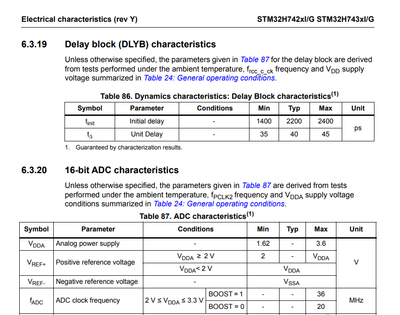

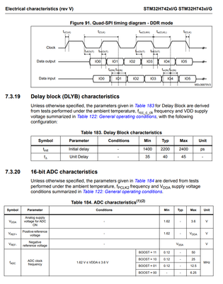

By checking the PMSM.ioc file, I noted that you are using a higher ADC clock source.
I recommend you to refer to the datasheet and check the maximum ADC clock frequency for different STM32H743 revision (rev Y and rev V).

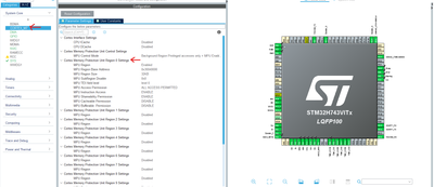

many thank for yours sharing, i adjusted ADC clock frequency, and config MPU 0 then it ran already
