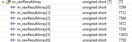

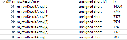

In debug, what I mean results are sliding in the array :
etc...
(while ~7000 raw data is zero current, ~14000 is equalt to 1.2 Amper. I'm applying the 1.2A to only one channel that has to be in the 3rd element of the array)

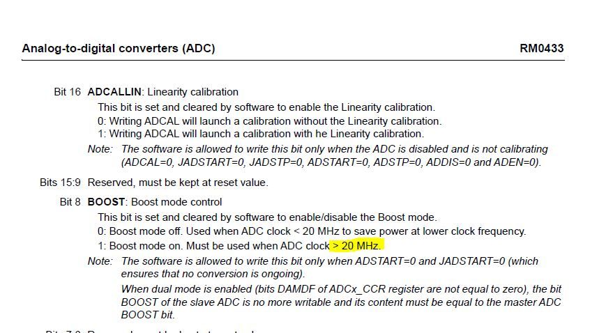

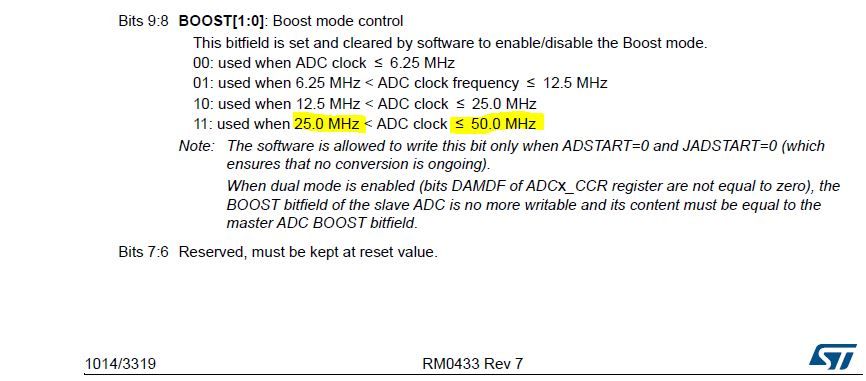

The Fadc is about 32Mhz .Is BOOST bit(s) set? (boost functionality differentiates with chip revision Y or V)
Thanks for reply! I changed the conditions in callback like you say. I was not aware of boost mode, it was on reset state. My chip is V revision, and I set the these two bits and I also observe in SFRs they changed to true state. But there is no timing differences.
