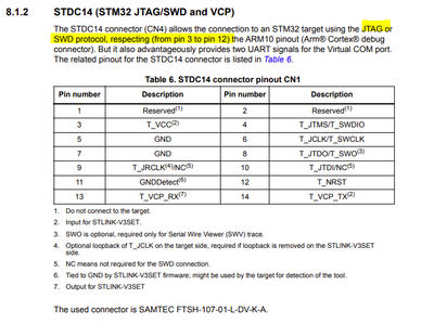

Hi everyone,
thanks for the many answers on short notice. Most things you mentioned I considered. Yet again, it was a small problem, which tjaekel post reminded me about.
We use a 10-pin jtag plug on our boards, which is different from the STLINK pinout. The first STLINK pinout you come across on the internet is also a 10-wire, so I build an adapter for it.
The problem is, the STLINK has a 14-pin on the debugger, where a 10-wire flat ribbon is put in the middle, meaning pins 1&2 and 13&14 are NC. I needed to change my adapter to that pinout and flashing with STLINKV3SET worked (see attached and UM2448).
This still doesnt answer why the segger j-link base does not work (pinning there is correct), or why the observed JTAG communication happens - but I can work with the STLINK, so that suffices.

Correct, I had same confusion: NUCLEO boards populate a 2x5 debug header (1.25mm pitch) but ST-LINK adapter has 2x7 pins. I have to "center" the 2x7 ribbon cable as well.
The left and right pin columns are not used. One side is intended to connect the VCP UART to the ST-LINK (coming from a real UART Tx and Rx on MCU, ST-LINK provides these as VCP UART - I do not use).
Here my ST-LINK header.
I went with the same layout as on NUCLEO boards. And I have to "center" the 2x7 ribbon cable.
