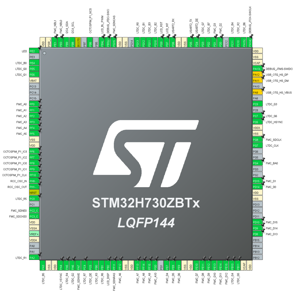

I have a custom board with a STM32H730ZB
I use a LCD 1024x600 controlled by LTDC.
Here is the pinout :
here is the config :
When executing code :
I break just after the HAL_LTDC_INIT function.
I should have a white screen (R=255, G=255, B=255)
But I have a strange color !
So I testes each bit of R[7..0] G[7..0] B[7..0] by modifying register :
 BCBLUE, BCGREEN and BCRED
Every bit works except
LCD_R7, LCD_B7, LCD_B6 and LCD_B4
Of course, my first thinking is a hardware problem..... but no
I focus on LCD_R7 :
1st test:
If I change LCD_R7 pin on PC4 in source code to OUTPUT_PP instead of ALTERNATE and set it to 1, the LCD draw the red background (I set all others bits to 0) => the color is 0x800000
==> So no hardware problem and LCD is OK
2nd test:
I move the LCD_R7 from PC4 to PG6, and the LTDC drive LCD_R7 correctly
==> So LTDC can drive LCD_R7 on PG6 (pin 91) but NOT on PC4 (pin 44)
Why those 4 pins are not drive correctly by LTDC on STM32H730ZB ?
