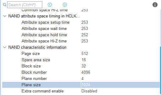

i am using stm3210e eval board. It has NAND flash memory of 512 Mbit and I am trying to read data from it but it gets inside hard fault handler. although i am able to read the device ID
Below is the code
NAND_IDTypeDef nand[1];
HAL_NAND_Read_ID(&hnand1,nand);
uint8_t read[10] = {0};
NAND_AddressTypeDef addr = {0,0,0};
HAL_NAND_Read_Page_8b(&hnand1,&addr,read,1);
the ioc file configuration

Hello @rahul7515 ,
Could you please take a look at FSMC_NAND and check you configuration.
The goal of this example is to explain the different steps to configure the FSMC and make the NAND device ready for access.
In this example, the NAND device is configured and initialized explicitly following all initialization sequence steps. After initializing the device, user can perform erase/read NAND ID/read data/write data operations on it.
May this FAQ can help you to debug a HardFault How to debug a HardFault on an Arm Cortex®-M STM32 - STMicroelectronics Community
I hope this help you.
