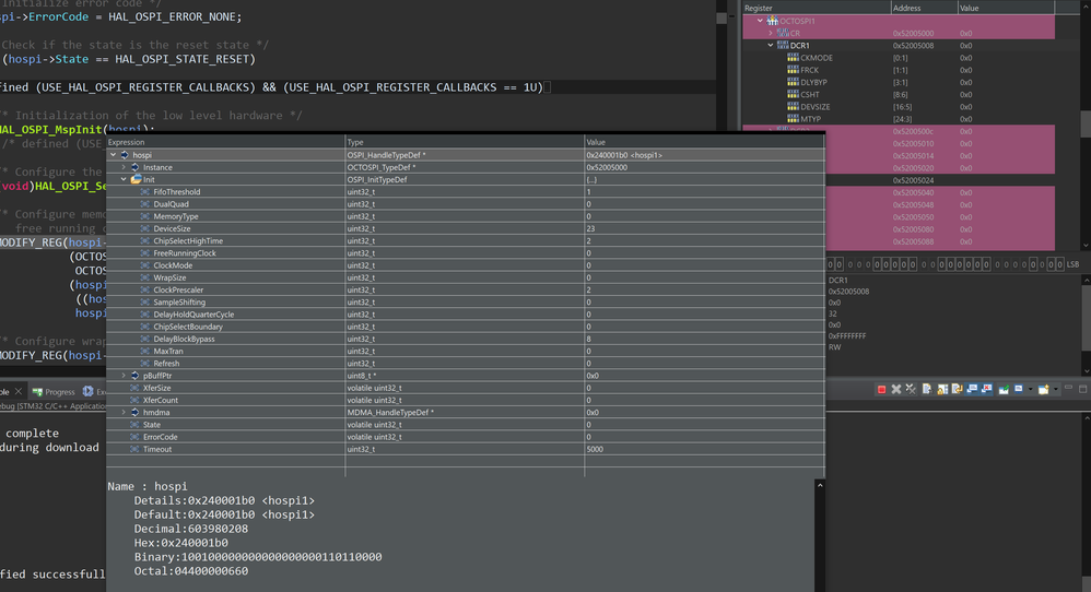

On a custom board using STM32H730ZB, I try to use QUAD SPI flash memory.
Here is the CubeMX config :
In MX_OCTOSPI1_Init function, I break on HAL_SPI_INIT function
This function come from pack STM32H7 version 1.11.2

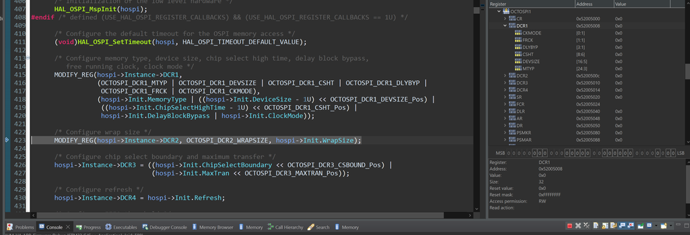

In line #415 of stm32h7xx_hal_ospi.c, the code should modify DCR1 register with this values :
You can see the DCR1value is 0x0
After executing the MODIFY_REG() macro, the DCR1 register remain at zero.
What can be the issue ?
I tried exactly same code with STM32H723 DK and register is update successfully.

Sorry for the late answer but now it works with H723, I had to give something working to my customer.
Here is the result :
UNIQUE 00230041-35325106-31383931
FLASH 128 KB
CPUID 411FC271 DEVID 450 REVID 2003
Cortex M7 r1p1
So I understand why !
Distributor send the reference STM32H750ZBT6 instead of STM32H730ZBT6
It is so difficult to read the reference on the components !
Now I will try with the right part.
