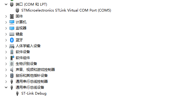

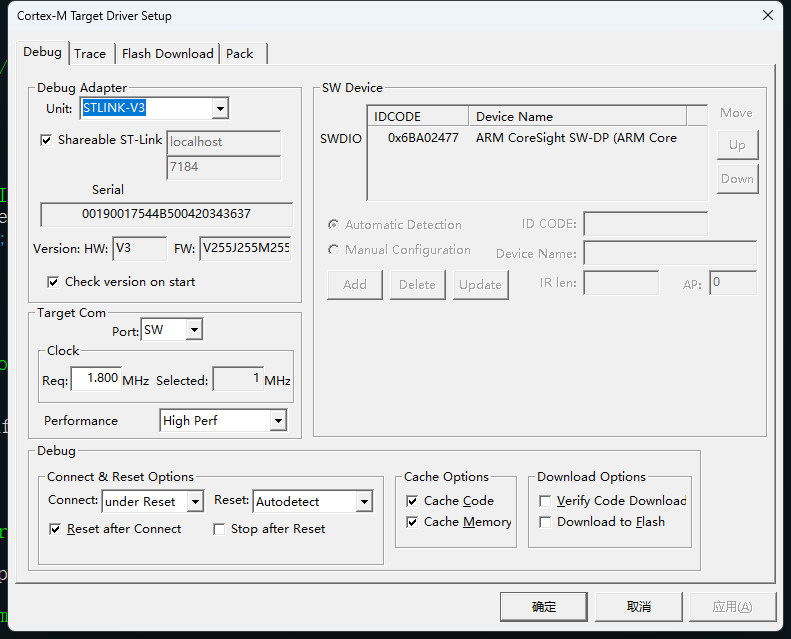

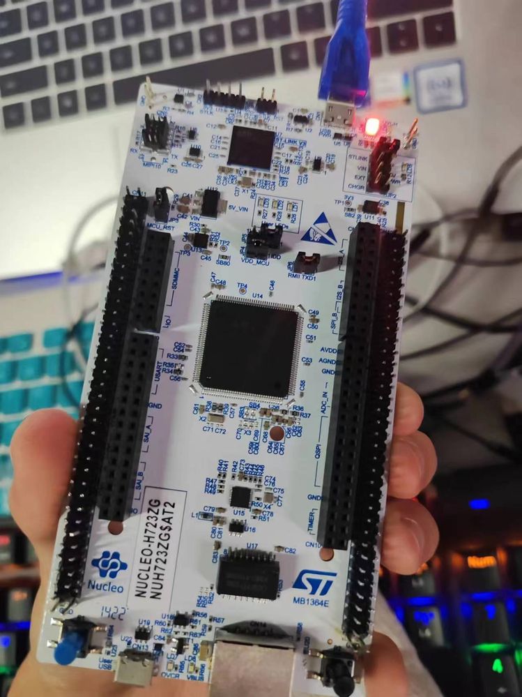

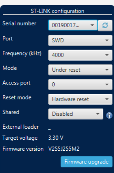

After I got the development board, I soldered it first. After soldering it, only the COM port light lit up red when I powered on for the first time, and the LED area and user buttons did not respond. After using the debug support of keilv5, I successfully read the port. However, I cannot connect to the hardware when using keil's ST download function. I tried to use cubeide to download again, but the port still could not be found, but my computer device manager could find the port and the universal serial bus device could query STM32 ST-Link/V3. I have the following screenshots as a supplement.

Hello @MM..1

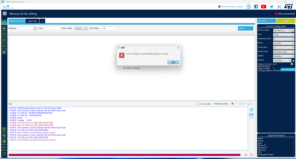

Thanks for your reply, I have tried connecting multiple times using STMCubeprogrammer, but the connection is sending errors. as the picture shows.
Best Regards.
ML111

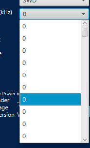

Frequency cant be zero, log messages dont equal right part window setup .... start with blue button Firmware upgrade.
ML111
Hello @MM..1
Thanks for your live reply.

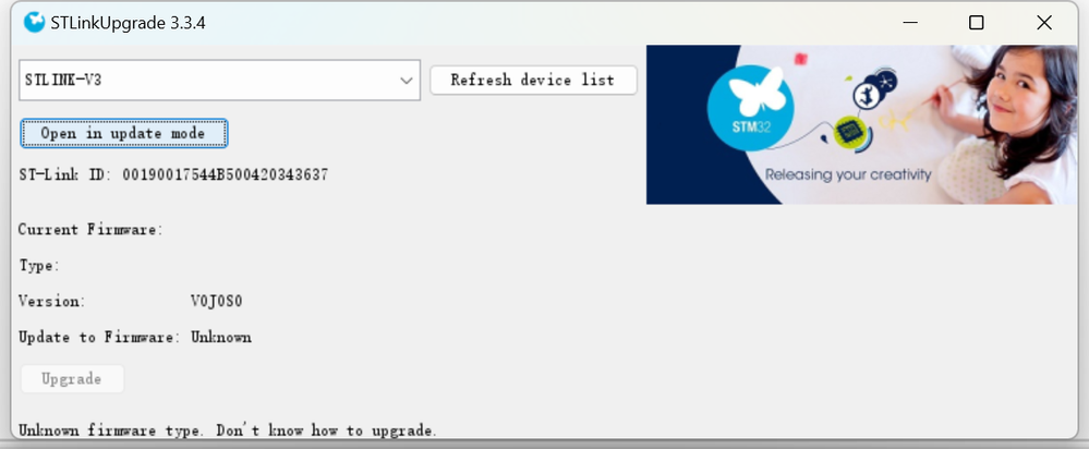

My frequency is only 0, no other options. as the picture shows.image.pngFirmware upgrade shows unknown firmware type.image.png

Hello @MM..1
I tried changing the PC and got the following results.c0628699b765ad88020ab2c4bf434f7.png4487cc232f7ac0229c7754b38f7799a.png424878ae801129843707adcdc54739e.pnga975c391652b893f54d2e01f9dd6481.png
Hmm try remove jumper ST-LINK pwr on nucleo and connect only STlink. After open upgrade window click Open in update mode. When requested disconnect and reconnect USB. Check if version show and upgrade ...
How is your OS? Too fw v 255 is ugly.
