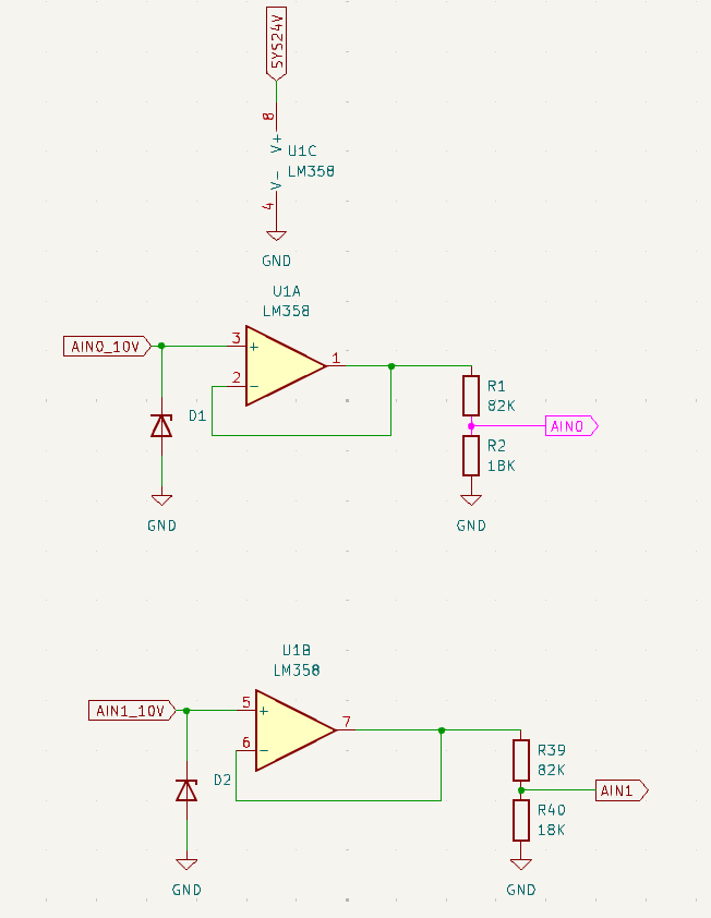

So what we have:
AGND is connected with general GND
VDDA is connected with general VDD (3.3V)
VREF+ is left open due to the internal reference configuration
The analogue inputs at PB0/PB1 (both configured as analog inputs with "no pull") come with a voltage divider to come from the 0..10V input value down to 0..1,8V range (with an op-amp in order to decouple this voltage divider from any inputs internal resistance):
As you can see, it is a custom board, so no Nucleo or DK from ST.

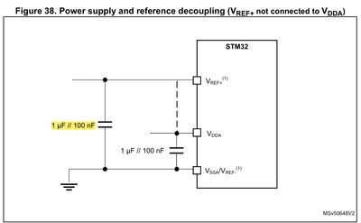

Is VREF+ bypassed to GND with a 1 uF + 100 nF cap? Or just completely floating? It needs the caps to be stable.
Have you grounded the ADC inputs directly (AIN0, AIN1) ?
And have you measured the opamp voltage at their outputs ?
> The analogue inputs at PB0/PB1 ... come with a voltage divider to come from the 0..10V input value down to 0..1,8V range (with an op-amp in order to decouple this voltage divider from any inputs internal resistance):
I suppose you know that in this kind of SA - ADC, the input source is supposed to charge/discharge the S&H capacitor to the respective potential in the configured sample time.
The S&H capacitor, together with the input impedance and external resistors, form a low-pass filter you need to match with your desired sampling frequency.
Although I think this is not you current problem, but an offset voltage on your opamp outputs.
No, the problem also happens when I connect PB0/PB1 to ground directly, means when the whole voltage-divider and op-amp stuff is not involved.
It is completely floating, right because VREG+ is configured in CubeMX  to be set internally completely. So this capacitor is still needed, even when I do not make use of this input?
