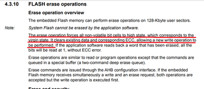

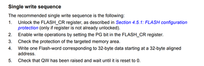

Hi STM Community,
I want to ask if I have to Erase Flash memory sector  (HAL_FLASHEx_Erase) before I write into flash memory (HAL_FLASH_Program)?
I tried it and nothing happend. I want to be sure, that is not an accident.

Hello, As said by @Andrew Neil this is the nature of the NOR Flash memory:
From the reference manual:
You can inspire from this example provided in STM32H7 Cube HAL:

Yes - that is the nature of Flash.
In STM32, you probably have to unlock before you can erase or write - check the chip's Reference Manual, and/or the HAL documentation ...
