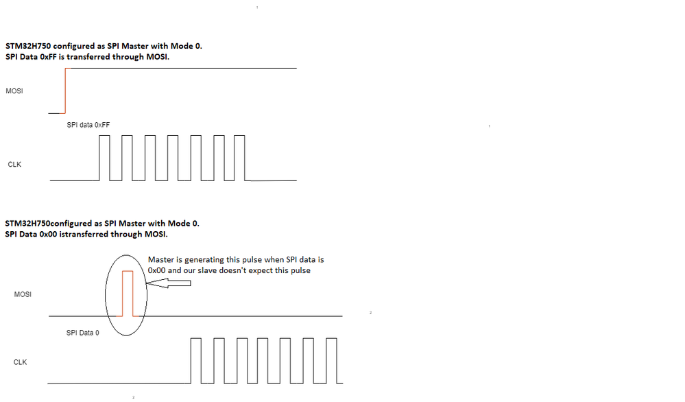

STM32H7 SPI configured as Master with the Clock Phase and Clock Polarity 0 (mode 0).  During the HAL_SPI_TransmitReceive() call, before the CLK the pulse is observed on the MOSI signal. Due to this the slave device is behaving differently. Agree the slave device should consider the data w.r.t clock, but for some use cases, our slave doesn't expect any change in the MOSI signal.
We would like to know the workaround for this (i.e MOSI should toggle/change the state only w.r.t the clock).
Please find the picture shown for reference.

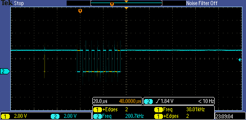

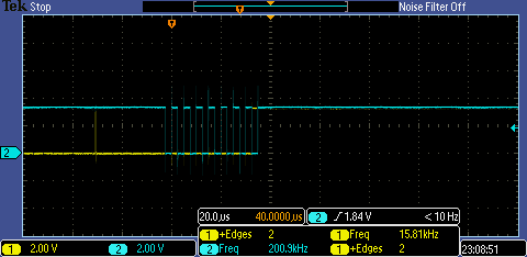

Regarding the workaround, our system is not only generating the waveform, in parallel we also need to capture the data using the MISO line.
For more information, I am attaching the scope-captured pictures.
0693W00000QNaEYQA1.pngData transmitting on MISO line is 0x01, SPI Mode-3
0693W00000QNaEEQA1.pngData Transmitting on MOSI is 0x81, SPI Mode-3
