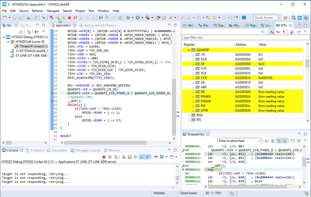

Executing this code sequence on a STM32H743ZI or STM32H743II
RCC->AHB3ENR |= RCC_AHB3ENR_QSPIEN;
	QUADSPI->CR = QUADSPI_CR_EN;
	QUADSPI->CCR = QUADSPI_CCR_FMODE_0 | QUADSPI_CCR_IMODE_0;
	QUADSPI->DR;
i.e. indirect read with only an instruction phase, then reading the data register freezes the MCU, i.e. no further instructions are apparently executed.
Debugger connection is lost, tries to reconnect a couple of times then gives up. I was able to reconnect the debugger only with Connect under reset enabled.
Watching the QSPI registers in the debugger has the same effect even when the DR register is not directly read by the code.
Workaround: avoid this sequence, use indirect write mode instead to send SPI commands with no parameters.

That's indeed unpleasant but works as expected/specified in RM: In indirect read mode any read access to FIFO stalls as long as there is not enough data available in the FIFO *and* BUSY is set . Hence no need to check FLEVEL, FTF or TCF before reading DR. But with no data phase there won't ever be enough data.
However, the interesting point is: After command completion BUSY should be cleared automatically, hence the bus stall should not last indefinitely? If it does, this would be a serious problem.
Regarding the debugger: It might be that it simply times out before BUSY returns to 0. You're using an ST-Link with OpenOCD? It's not usual that after a timeout the debugger can't regain control and only a target reset can resolve this. In fact, I observed this after a bus stall with OCTOSPI.

The problem is that BUSY is apparently never cleared, at least not whithin a minute. It can be aborted though.

If you read DR, it stalls.
If you don't read DR, you can observe that BUSY is never cleared, and you can set QUADSPI_CR_ABORT.

Just checked on Nucleo-H743ZI2: If DLR is cleared, BUSY bit sticks at 1, *no* other flag set. If DLR if set to 0xFFFFFFFF (the idea was that maybe BUSY is only cleared when transfer counter reaches 'nothing left' state) before writing to CCR, BUSY still remains set, but now TCF is set.
So, clearly, the BUSY reset logic has a flaw.
