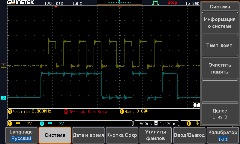

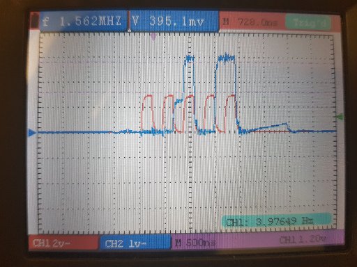

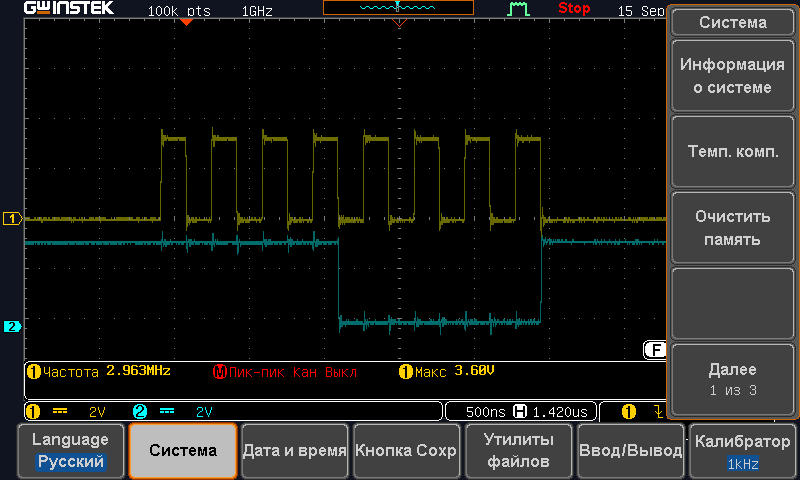

I have a problem when using QSPI with NOR flash. Some read commands return data with first 4 bits corrupted.
After investigation, I have found that the issue only appears if there is switch from output to input without dummy cycles.
For example (see picture): I send a 4-line, 1 byte instruction (2 cycles) and read 4-line 3 bytes (6 cycles). I expect IO2 (blue) to switch from output to input prior to clock's (yellow) third falling edge. Instead, it seems to be held at some grey level, that is sometimes sampled as 1 at the third rising edge.
Same issue was observed on STM32H7 with 2 different flash chips, using quad-spi and dual-spi.
Yellow is clock, blue is IO2
I can’t find something similar in errata.
Are some ideas, guys?

‎2021-09-15 2:59 AM
The picture quality isn't a concern by itself, just some details (e.g. timebase) are simply not visible ...
Would you mind to give a *precise* description of you setup (which H7 device, package, pins used for QSPI or maybe OctoSPI, register settings???). I've used several L4, F7 and H7 devices with QSPI and OctoSPI, and I didn't experience any problem yet with the RDID 0x9F (or 0xAF) command in any mode nor any of the usual read/write commands. There are some problems indeed, but so far they appeared only with 'exotic' settings or regarding the bus interface.

I tried to tweak everything, but only QSPI_SAMPLE_SHIFTING_HALFCYCLE fixed broken read. This is expected, as the issue goes away at the clock's rising edge, so sampling in the middle of high clock cycle returns correct bits.

I have shown another example with a different flash chip to help narrow down the root cause. In both cases we write '1' on one clock cycle and read the same line on the next clock cycle. Sometimes we read '1', where it should have been '0'. Sometimes we read '0', but for the entire duration of clock's down cycle, the line is being held at around 1 volt, confirming that the issue still exists even if we were lucky to read correct bits.

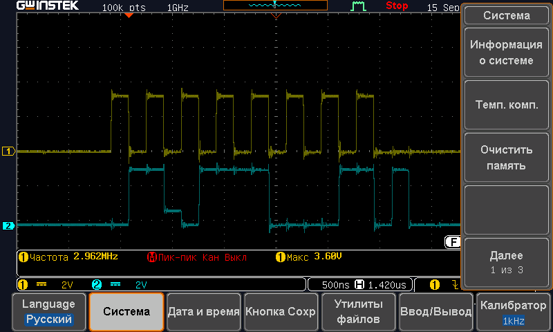

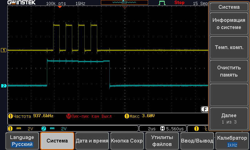

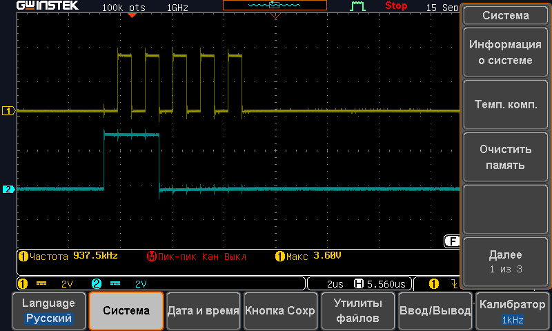

Here are better quality pictures (yellow - clock, blue - IO0, IO1, IO2, IO3):
As you can see, IO1 and IO2 have some strange behaviour after second falling edge. As a result, we read 0xFD instead of expected 0x9D.
‎2021-09-15 6:15 AM

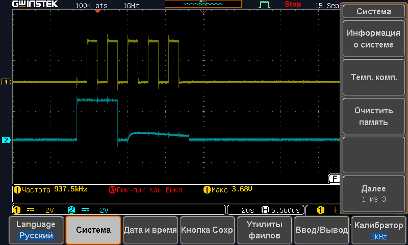

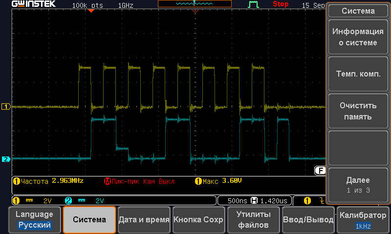

I also tried to reproduce a minimal example:
I have sent command 0xAB (Read Product ID) in qpi mode (4-4-4), then 0 or 1 dummy cycles, then read 1 byte. There are 6 dummy cycles required by flash datasheet, so flash should not write anything.
0 dummy cycles:
1 dummy cycle:

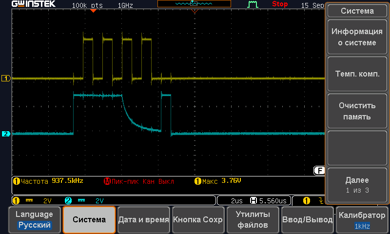

As you can see, IO1 keeps high signal without dummy cycles. I also tried connecting IO1 to ground via 9kOm resistor.
With resistor, 0 dummy cycles:
With resistor, 1 dummy cycle:
It seems that controller does not switch IO1 to input on the second falling edge, but instead does it on the third rising edge, where data is already being sampled.

Nucleo-H743ZI2 with two W25Q256FV attached in dual mode (flash1 uses the very same pins as in your setup), again yellow is CLK, cyan IO2, purple NCS1. Clearly there is this intermediate level between second falling and third rising clock edge. However, this is *NOT* caused by the QSPI interface but by the flash chip itself!
The second picture shows the very same situation but only with the flash chips physically removed. No intermediate level at all, but continous high level (due to pull-ups being active).
So, yes, using SSHIFT=1 is mandatory here. The description "By default, the QUADSPI samples data 1/2 of a CLK cycle after the data is driven by the Flash memory. This bit allows the data is to be sampled later in order to account for external signal delays." is rather consistent with the present situation: The flash simply assert its data too late to be correctly sampled without this additional shift. In my setup SSHIFT=1.

1. We both used relatively low clock speed, there is at least 180ns before falling edge and sampling. My flash requires 8ns at most, according to datasheet, I don't believe it needs an extra half cycle to assert data. Furthermore, I tried downclocking to a lowest possible speed and the issue persists. The intermediate level is rather stable and does away immediately at the rising edge.
2. I tried pulling data line directly to ground (please see comment below) and it clearly shows that stm is holding high signal after second falling edge. I bet you can try doing the same without a flash chip and verify when the line switches to input.
‎2021-09-16 12:01 AM
Yes, you're certainly right that the QSPI interface keeps its output active longer than necessary, so that there is a conflict of QSPI and flash, both being outputs momentarily. But still I don't see any real problem there, just set SSHIFT=1, and everything works as desired.

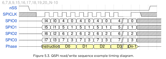

I am sorry if I interrupt this discussion. I have the very similar problem as of Ilya Balov.
This is the timing diagram of my QSPI device. And there is no dummy cycles I can add.
Below is the value of SIPO3. The command is one byte and occupies first 2 clocks. I expect 3 rd bit to be one from the slave device. The voltage level is around 1.2V as can be seen in the picture below.
I did experiment with every single options of STM32F7 QUADSPI controller but it didn't work.
I suspect that the SPIO3 pin was not switched to input on time. Then the equivalent circuit of voltage divider connecting the slave output to the master output of F7 gives the weird result I guess.
I hope I can get some hint from this discussion.
