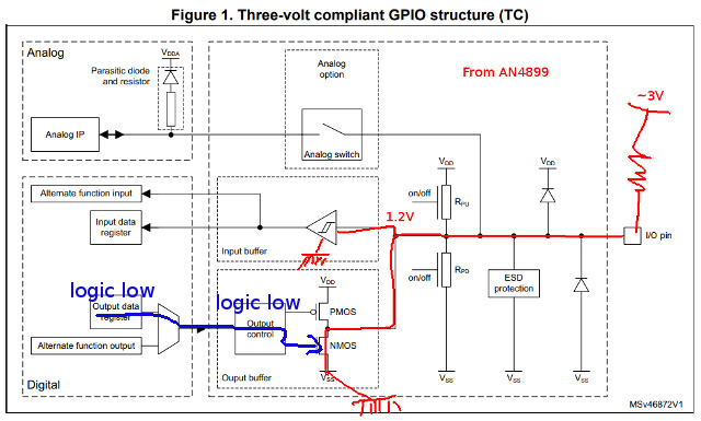

More precisely, my suspicion is...
Output block of F7 QSPI controller remains active when input block gets active on 3rd clock. That makes the total impedance of F7 SPIOx very small. 44Ohm is used to supress ringing(for termination purpose). This termination resistor divides ~3V with the output block of F7 SPIOx. Reading level gives 1.2V at this point. On the rising edge of 3rd clock, output block of F7 SPIOx gets inactive and the total impedance of F7 SPIOx is now restored to the impedance of input block of F7 SPIOx pins and so the voltage level gets back to ~3V.
In case of Ilya Balov, the commands ends with 1 and output register has value 1. And it causes the voltage level not to be zero.

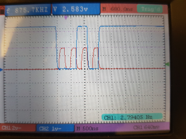

equivalent measurement of the same pin with ATSAMV71 and the same device. no half cycle delay for sampling and data pin pulled up. And sampling polarity(or whatever) is different. No problem with the QSPI device.
red is clock and blue is data pin.
My device counts the number of clocks, which is used internally in the device to indicate the offset of device memory. That's why additional clock generated by half cycle delay causes another problem. Half cycle delay does not work for me!!!

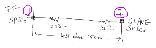

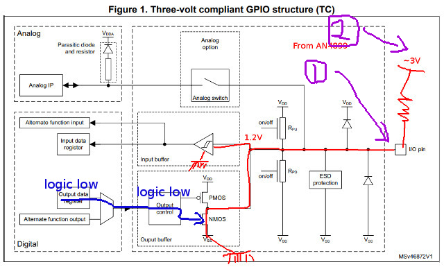

1.2 V voltage is a problem, whichever is responsible for it. It seems possible to determine which is the culprit by measuring the voltage. I will measure the voltages at points 1 and 2 depicted in the picture below. 2 is the output pin of the slave device. We can observe the voltages at points 1 and 2 of SPIOx pins during the 3rd clock. I hope you understand this is not a configuration issue but an input impedance issue.
0693W00000GYMNdQAP.png3 possible outcomes (whose 3rd bit of SPIx is logic high, no dummy cycles are set)
  1. 1 and 2 are both close to 3V : good
  2. 1 is 1.2V and 2 is close to 1.2V (actually a little bit higher)
  3. 1 is 1.2V and 2 is 3V
case 1 means that we have no problem.
case 2 proves that slave device is doing something wrong.
case 3 proves that F7 QSPI controller is a problem.
Rough physical layout is as below.
0693W00000GYMRbQAP.pngIf you agree on my experiment plan, I will proceed. It will take time to get the result because my company is based on other country and I have to arrange this.
Please let me know your opinion about my suggestion.

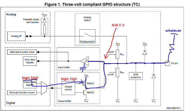

Another problem is the maximum sinking current on both master/slave sides, which is 25 mA for F7. If the outputs of master and slave are both active and they have different logic levels, the current can be bigger than 25 mA. In my setting, it is about 30 mA. Even though the duration of this huge amount of current is very short, it is not good for the QSPI output MOSFET. It has to be taken care of.

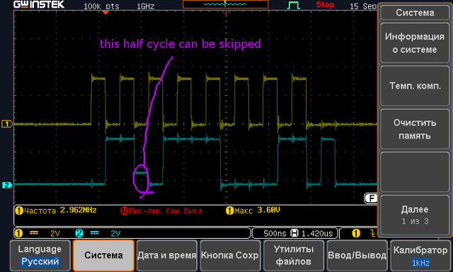

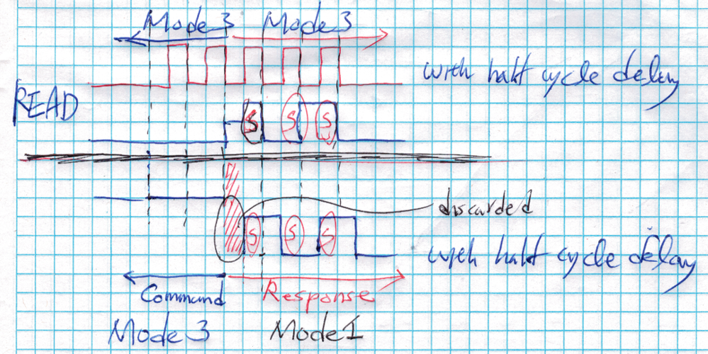

One solution for maximum sinking current is to use different modes on master and slave. I didn't test it but I think it will work. I've been using mode 3 on both sides. When slave is changed to use mode 1 with half cycle delay active on master side, then the problematic half cycle will not be used. My slave device support mode1 and mode3.
if only the half of 3rd clock is a problem, it can be skipped by mixing modes (in my thought).

I never tried using different modes for spi master and slave. STM32H7 does not support modes 1 and 2, but I see what are you trying to do. Are you able to configure slave mode 1ONLY for response (i.e. keep using mode 3 for command, address, write data)? Also note, you would be forced to use sample shifting. If all of these are ok for you, I don't see why this wouldn't work (although looks like a dirty hack, if you ask me).

master : mode 3 with QSPI_SAMPLE_SHIFTING_HALFCYCLE on
slave : mode 1
Then master will samples during the first half cycle at each clock I reckon. Master don't care when slave outputs. I calculated the timing.

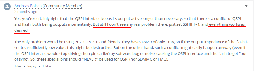

It's certainly a silicon bug (and that's not the only one, check the various errata sheets for devices with QSPI or OCTOSPI ...). But the sample shift is a simple workaround which works in most cases. (As I said before, the PCx_C shouldn't be used as they're easily destroyed by a conflict.)
But on the other hand: The RMs say very explicitly that QSPI is intended for flash devices. For anything else you may say "Your mileage may vary". I''m afraid there is little hope ST will make a new silicon revision ...
For flash devices there is even another workaround, namely (unneccessary) dummy cycles. The only transfer mode really affected is indirect read for status register, and here most (all) devices simply repeat its contents indefinitely, so sampling e.g. the second byte instead of the first doesn't matter. All other register reads or id reads could and should be done in simple SPI mode before switching to QPI mode,
