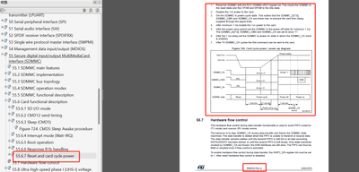

I had the same problem,this is my soultion
void MX_SDMMC1_SD_Init(void)
hsd1.Instance = SDMMC1;
hsd1.Init.ClockEdge = SDMMC_CLOCK_EDGE_RISING;
hsd1.Init.ClockPowerSave = SDMMC_CLOCK_POWER_SAVE_DISABLE;
hsd1.Init.BusWide = SDMMC_BUS_WIDE_4B;
hsd1.Init.HardwareFlowControl = SDMMC_HARDWARE_FLOW_CONTROL_ENABLE;
hsd1.Init.ClockDiv = 2;
// step to init card ref form RM0433.pdf-Page2429
//step1:Reset the SDMMC with the RCC.SDMMCxRST register bit
__HAL_RCC_SDMMC1_FORCE_RESET();
__HAL_RCC_SDMMC1_RELEASE_RESET();
// step to init card step2:Disable the Vcc power to the card
HAL_GPIO_WritePin(PE2_GPIO_OUT_GPIO_Port, PE2_GPIO_OUT_Pin, GPIO_PIN_RESET); //PE2 used control SD card power!
HAL_Delay(2);
//step3:Set the SDMMC in power-cycle state init sd gpio!
SDMMC_PowerState_Cycle(SDMMC1);
HAL_SD_MspInit(&hsd1);
//step4:After minimum 1 ms enable the Vcc power to the card!
HAL_Delay(2);
HAL_GPIO_WritePin(PE2_GPIO_OUT_GPIO_Port, PE2_GPIO_OUT_Pin, GPIO_PIN_SET);
//step5:After the power ramp period set the SDMMC to the power-off state for minimum 1 ms
HAL_Delay(1);
(void)SDMMC_PowerState_OFF(SDMMC1);
HAL_Delay(2);
// normal init!
if (HAL_SD_Init(&hsd1) != HAL_OK)
Error_Handler(__FILE__, __LINE__);
see detail in here
