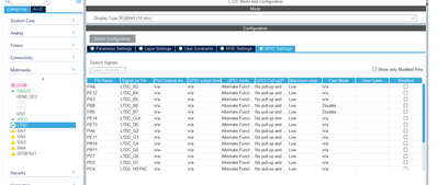

Hello, I want to use LTDC on the STM32H743VIT6 microcontroller, but when I enable this peripheral in CUBEMX, it does not activate correctly. For example, the pins for B are from B3-B7, while they should be from B0-B4, and the same goes for R, G.

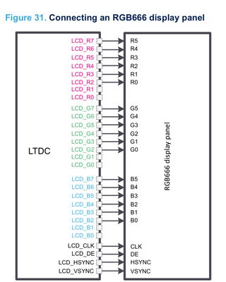

I’m not an LTDC expert. But, think this is normal and no problem with this configuration according to the figure 32 of the AN4861, on a RGB666 display, the B  pins should be from B2 to B7 and not from B0 to B5 as on the display side. Same for G and R pins:
Best Regards.
