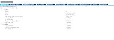

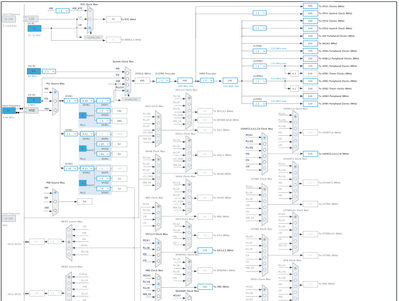

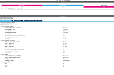

I am working with a custom board using the STM32H757BIT and a Riverdi RVT70HSMNWC00 connected through MIPI DSI.
I followed the “lv_port_riverdi_70-stm32h7” example for the CubeMX setup and for the DSI display initialization.
The system runs from a 25 MHz external HSE, and I have tested the DSI clock using both the HSE and PLL2Q.
HAL version: V1.12.1.
The UI framework is LVGL.
My issue is that the display stays completely black. When LVGL triggers the flush callback, nothing appears on the screen.
The backlight PWM is working correctly: it runs at 48 kHz and currently uses a duty cycle above 90%, so the panel should be fully illuminated.

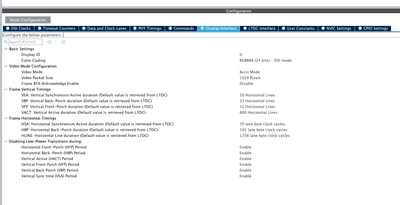

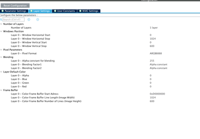

I have the system configured with double buffering using external RAM, with the LVGL buffer in Direct mode.
The flush function is called only once. I have verified that the buffer currently used is the correct one, and debugging shows that the external RAM buffer is filled correctly with the expected image.
Flush CB
if (lv_display_flush_is_last(disp)) {
		SCB_CleanInvalidateDCache();
		// wait for VSYNC to avoid tearing
		while (!(LTDC->CDSR & LTDC_CDSR_VSYNCS));
		// swap framebuffers (NOTE: LVGL will swap the buffers in the background, so here we can set the LCD framebuffer to the current LVGL buffer, which has been just completed)
		HAL_StatusTypeDef ret = HAL_LTDC_SetAddress(&hltdc, (uint32_t)(lv_display_get_buf_active(disp)->data), 0);
 SEGGER_RTT_printf(0, "HAL_LTDC_SetAddress returned %d\n", ret);
	lv_display_flush_ready(disp);

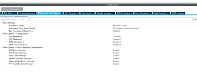

Display Initialization Sequence
I am initializing the DSI display using the following commands:
 ret = HAL_DSI_Start(&hdsi);
 ret = HAL_DSI_ShortWrite(&hdsi, 0, DSI_DCS_SHORT_PKT_WRITE_P0, DSI_SOFT_RESET, 0x0);
 HAL_Delay(120);
 ret = HAL_DSI_ShortWrite(&hdsi, 0, DSI_GEN_SHORT_PKT_WRITE_P2, 0x87, 0x5A);
 ret = HAL_DSI_ShortWrite(&hdsi, 0, DSI_GEN_SHORT_PKT_WRITE_P2, 0xB0, 0x80);
 ret = HAL_DSI_ShortWrite(&hdsi, 0, DSI_GEN_SHORT_PKT_WRITE_P2, 0xB2, 0x50);
 ret = HAL_DSI_ShortWrite(&hdsi, 0, DSI_GEN_SHORT_PKT_WRITE_P2, 0x80, 0x4B);
 ret = HAL_DSI_ShortWrite(&hdsi, 0, DSI_GEN_SHORT_PKT_WRITE_P2, 0x81, 0xFF);
 ret = HAL_DSI_ShortWrite(&hdsi, 0, DSI_GEN_SHORT_PKT_WRITE_P2, 0x82, 0x1A);
 ret = HAL_DSI_ShortWrite(&hdsi, 0, DSI_GEN_SHORT_PKT_WRITE_P2, 0x83, 0x88);
 ret = HAL_DSI_ShortWrite(&hdsi, 0, DSI_GEN_SHORT_PKT_WRITE_P2, 0x84, 0x8F);
 ret = HAL_DSI_ShortWrite(&hdsi, 0, DSI_GEN_SHORT_PKT_WRITE_P2, 0x85, 0x35);
 ret = HAL_DSI_ShortWrite(&hdsi, 0, DSI_GEN_SHORT_PKT_WRITE_P2, 0x86, 0xB0);
 HAL_Delay(50);
 ret = HAL_DSI_ShortWrite(&hdsi, 0, DSI_DCS_SHORT_PKT_WRITE_P0, DSI_EXIT_SLEEP_MODE, 0x0);
 HAL_Delay(120);
 ret = HAL_DSI_ShortWrite(&hdsi, 0, DSI_DCS_SHORT_PKT_WRITE_P0, DSI_SET_DISPLAY_ON, 0x0);
 HAL_Delay(120);
Everything seems to execute without errors, but the display remains black.

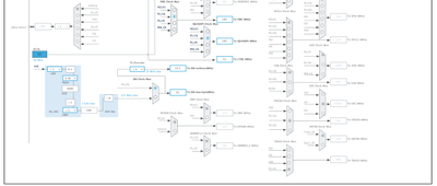

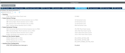

Frequency
DSI: 62 MHz
DSI txclkesc 15.5 MHz
LTDC: 52 MHz
CubeMX setup

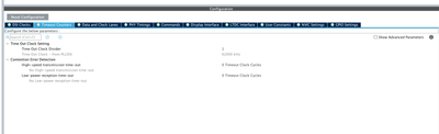

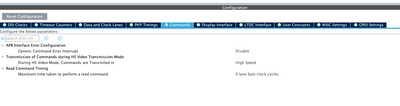

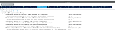

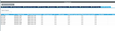

I am attaching images of my CubeMX configuration for:
  • System Clock
  • DSI
LTDC:
Has anyone faced similar issues or sees something clearly wrong with this setup?
Any help would be greatly appreciated.
