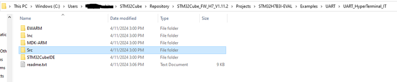

ST has a lot of examples. For the H7 you can look at the repository it created

Thank you ... confirms I have to call the receive function to make the interrupt occur.
I will experiment with that as the length is not fixed it varies.
