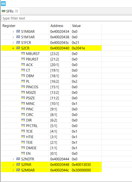

Yes, DMA2 Stream 2 configuration register gets set in HAL_SPI_Receive_DMA function
Here is register :

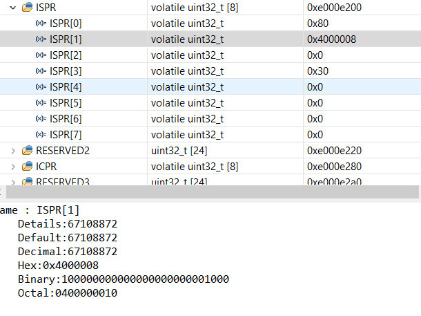

@Community member​
Thank you for the help,
NVIC Pending register after first Rx : The bit 35 is 1 (SP1) and the bit 58 is 1 (DMA2 Stream 2), but my breakpoints in both Handler aren't triggered (I will try GPIO debug)
0693W000008wHVOQA2.pngFor priority, I registered my interrupts at level 0 or 1 (highest) because in my application SPI1 Rx is the most critical process
waclawek.jan
Maybe interrupts are globally disabled.
This is in PRIMASK, which is a processor internal register, I don't know if and how your debugger can display it.
Also, you may be inside an interrupt of the same or higher priority. Check IPSR (again, a processor internal register).
You can also have a look at the SCB_ICSR register, that should contain the currently executed interrupt number (or 0 if no interrupt), too.
