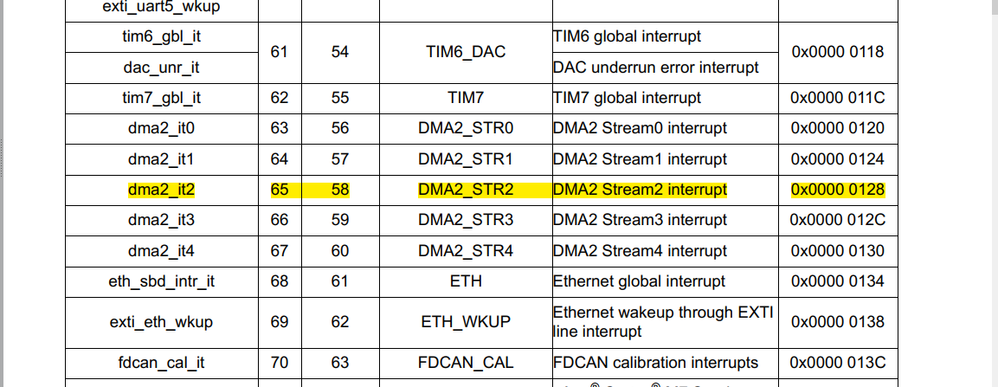

Update I also checked NVIC ISER and NVIC->ISER[1]=0x400 0000 which means the bit 58 is 1, it is DMA2 Stream2 interrupt

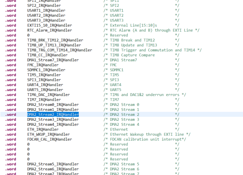

In my startup_stm32h743xx.s, DMA2_Stream2_IRQHandler is registered here :
0693W000008wGPPQA2.pngAnd in "stm32h7xx_it.c" :

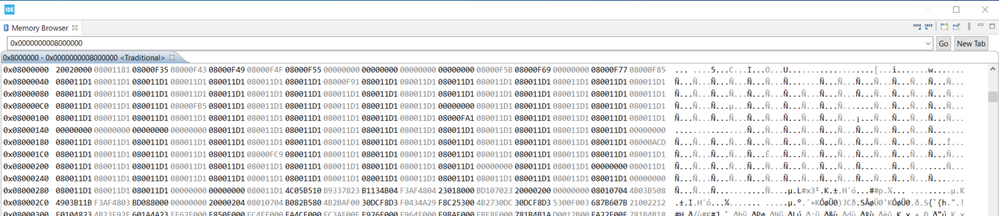

From looking at map file, DMA2_Stream2_IRQHandler address is 0x0000000008000fa0
With memory browser, I see a 08000FA1 value at 0x8000128 address.
0693W000008wGWLQA2.pngIt is the correct position and value (good news but bad news for diagnostic)
0693W000008wGotQAE.pngAlso I checked and SCB->VTOR = 0x8000000
