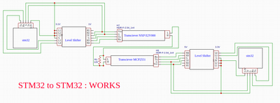

  1. Stm32H7 to Stm32H7 Nucleo Board Can Bus works.

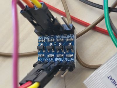

  1. Checked wirings for High to High and Low to Low and Tx and Rx as well.
  2. Checked voltages for Rx pins at 3.3v( using level shifters wit h transciever)
  3. Checked termination resistance and have tested the connections in isolation with both ends terminated with 120ohms ie (stm32- > stm32, Stm32-> adapter, Stm32 -> Orin)

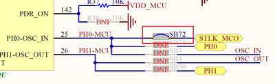

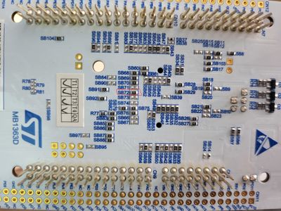

Don't forget to check:
SB72 and R5 should be soldered:

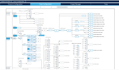

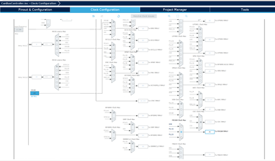

I tried what you suggested, but seems like I am still missing something.
  • configured HSE to use Nucleo Clock.
  • Changed clock configuration for HSE ->PLL1Q and PLL1Q -> FDCAN
  • Input clock changed to 8 mhz.
  • Verified SB72 is jumped and R5 is present. do I need to remove R5 and jump it?

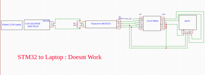

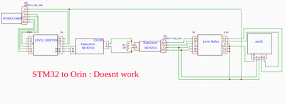

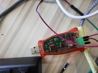

draw a block diagram of how you're connecting the H7/CAN transceiver to the Canable. Include the terminating resistors, ground reference. Is the terminating resistor on the Canable enabled?
Canable are made from all kinds of 3rd party vendors. Some have isolation circuits. Do you have V1, V1 Pro or V2 of the Canable? A link to the Canable would help.

"do I need to remove R5 and jump it?"
-> No need for that.
Could you please check with an oscilloscope the HSE frequency using MCO pin (PA8)? Do you get 8MHz?
I've attached your ioc file where I enabled MCO on PA8 to output a mirror of the HSE signal.

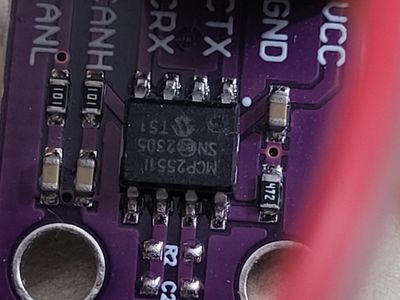

Need also to share with us more details about your HW, the transceivers part number (if possible the schematics of that part) you are using and as stated by @Karl Yamashita a block diagram of your connections and check the availability termination resistors at each node side: you need only two terminating resistors (no more nor less) of 120 ohm at both sides of the bus.

Sorry I could not get back earlier.   
Please see below for the transceivers and the schematics of the circuits.     
Please note I don't have a scope, and I have just ordered one and will take me a couple days to report the results.

More than likely the level shifter is causing an issue. An oscilloscope will help determine what is going on.
Also, I assume that you didn't connect the 3.3V to ground as shown in the schematic?
If a reply has proven helpful, click on Accept as Solution so that it'll show at top of the post.
CAN Jammer an open source CAN bus hacking tool
CANableV3 Open Source
Amogh
Hi Karl,
Yea, in first image stm32 to stm32 where can bus works there was an error with wiring. please see attached revised.  
In my opinion level shifter is not the culprit because stm32->stm32 can bus works. Would you not agree?

Thanks @Karl Yamashita @mƎALLEm
My Can BUS works. I think it was a combination of clock, Bit timing parameters, and (maybe) RCC Prescaler disabled.
