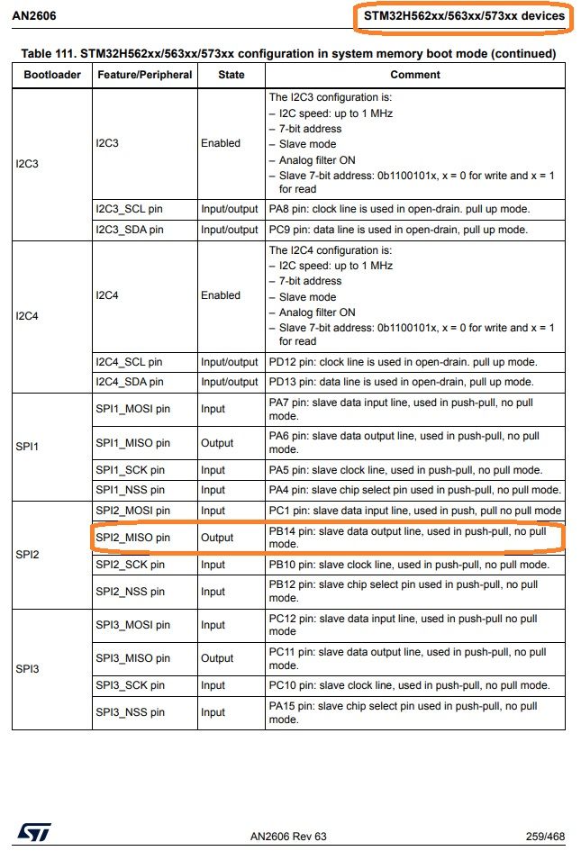

If what you've wired has established a conduction path, it really doesn't matter. A device with blank FLASH will run from ROM. PB14 is potentially set as an output, per AN2606
If the LED is emitting photons, it's because electrons are flowing, conduction is occurring, resistance is limiting the amount. Put more resistance there so it's not permitting 7mA to flow.
https://www.st.com/resource/en/application_note/an2606-stm32-microcontroller-system-memory-boot-mode-stmicroelectronics.pdf
So the bootloader is started and sets PB14 as uartTX :
ed: as SPI2 output :
When you have flashed a valid program and dont start the bootloader, (boot0 = lo ),
but your program, PB14 will work as you want.
You sure? My AN2606 for the STM32H573 shows it uses PB14 for SPI2_MISO, in a context where the STM32 is the SLAVE device. It's perhaps arguable WHEN that occurs, and if it's only after CS is seen to go low, or at reset. On the UART RX are connected to TIM inputs to measure the 0x7F 8E1 pattern before enabling the UART and UART TX output.
