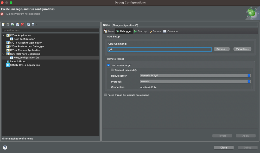

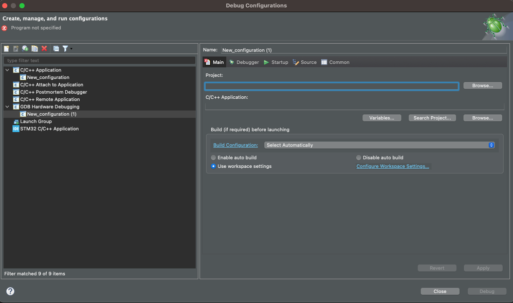

I am not seeing OpenOCD as an option. Also, my ultimate goal is to use Rust as a programming language. It looks like CubeIDE does not support this. What would be the best way to get this to work.Screenshot 2024-02-28 at 7.55.12 PM.pngScreenshot 2024-02-28 at 7.54.20 PM.png

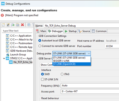

Pavel A.
Select STM32 application. You've selected generic C++ app. (no idea why they left it in the menu).
Rust... Sorry, not my sort of burger. In Rust we don't trust.

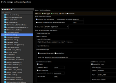

As Pavel writes, select stm32...appli. , like mine here:
