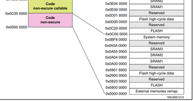

I am working on freertos plus tcp library with STM32H563ZI, but how must I make memory otions in linker file?
like:
RAM (xrw) : ORIGIN = 0x20000000, LENGTH = 320K
FLASH (rx) : ORIGIN = 0x08000000, LENGTH = 2048K
RAM1 (xrw) : ORIGIN = 0x20000000, LENGTH = 256K
RAM2 (xrw) : ORIGIN = 0x20040000, LENGTH = 64K
RAM3 (xrw) : ORIGIN = 0x20050000, LENGTH = 320K
it is wrong I know but how can I make this right ?

‎2023-09-06 8:24 AM - edited ‎2023-09-06 8:25 AM
Hi @Recep ,
You need to modify the SRAM address as showing :
SRAM1 : 0x0A00 0000
SRAM1 : 0x0A04 0000
SRAM1 : 0x0A05 0000
Foued
‎2023-09-06 9:01 AM - edited ‎2023-09-06 9:03 AM
The Programmers don't want to write into RAM spaces. These either need to be NOLOAD sections, or you need to stage them in FLASH, and copy them to the final destinations via code in startup.s
That code needs to copy or zero the RAM content as appropriate.
The Linker Script also presumes the memory regions don't overlap, doing so will result in variables/structures being given the same addresses and conflicting when used.
