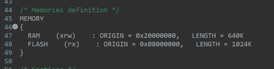

The project I created using CubeIDE should not have any issues with link file exceptions, and I have also checked the. ld link file. The size of the Flash space allocation is also 1MByte.

The allocation of RAM and Flash in my link file is also the same as yours:

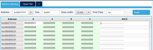

You can see that my burned file exceeds 512KByte:

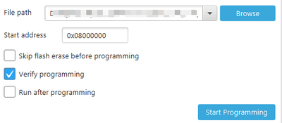

I have checked the 'Verify after downloading' option:
As shown below, the verification failed at position 0x08080000:

Reading the data at position 0x0807FFFF, it can be seen that the data in the subsequent FLASH is all 0:

Seems like an STM32CubeProgrammer bug. It does download successfully, though. At least it claims as such. Wonder if the flash is correct but it's not being read out correctly. All 0x00 seems unlikely to be real and more likely to be a bug.
Wonder if you could disable the "verification" step and see if it works.
I don't have an H5 board to test unfortunately.

Thank you very much for your suggestion. I tried to disable the 'verify after download' option, but the result is still the same. I am not sure if it is an issue with the STM32CubeProgrammer.

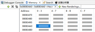

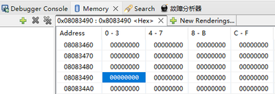

I tried to read the data after 0x08080000 in the debugging window, and the result was the same:
