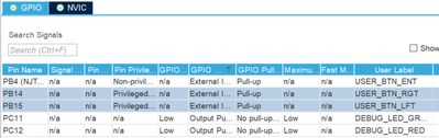

I have an issue in STM32U5A9 IN EXTI interruption.
When PB4, PB14, and PB15 are set to EXTI with interruption, EXTI15 interruption is activated by the signal of PB14.
And EXTI15 interruption isn't activated by the signal of PB15.
All EXTI settings are Pull-up and External Interrupt Mode with Rising / Falling edge trigger detection

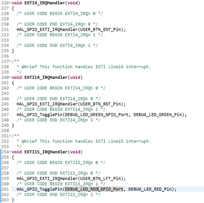

Hello Sarra.S, thank you for replying.
PB15 function set as only EXTI15 as following.
I searched for EXTI15_10_IRQHandler but it could not be found.
CubeIDE didn't seems to generate EXTI15_10_IRQHandler().
But EXTI14_IRQHandler() and EXTI15_IRQHandler() were generated as following.
(I appended LED toggle lighting code to each functions for debug.)
I tried setting PB13 as EXTI13.
EXTI13_IRQHandler() was generated and activated by the signal of PB13.
