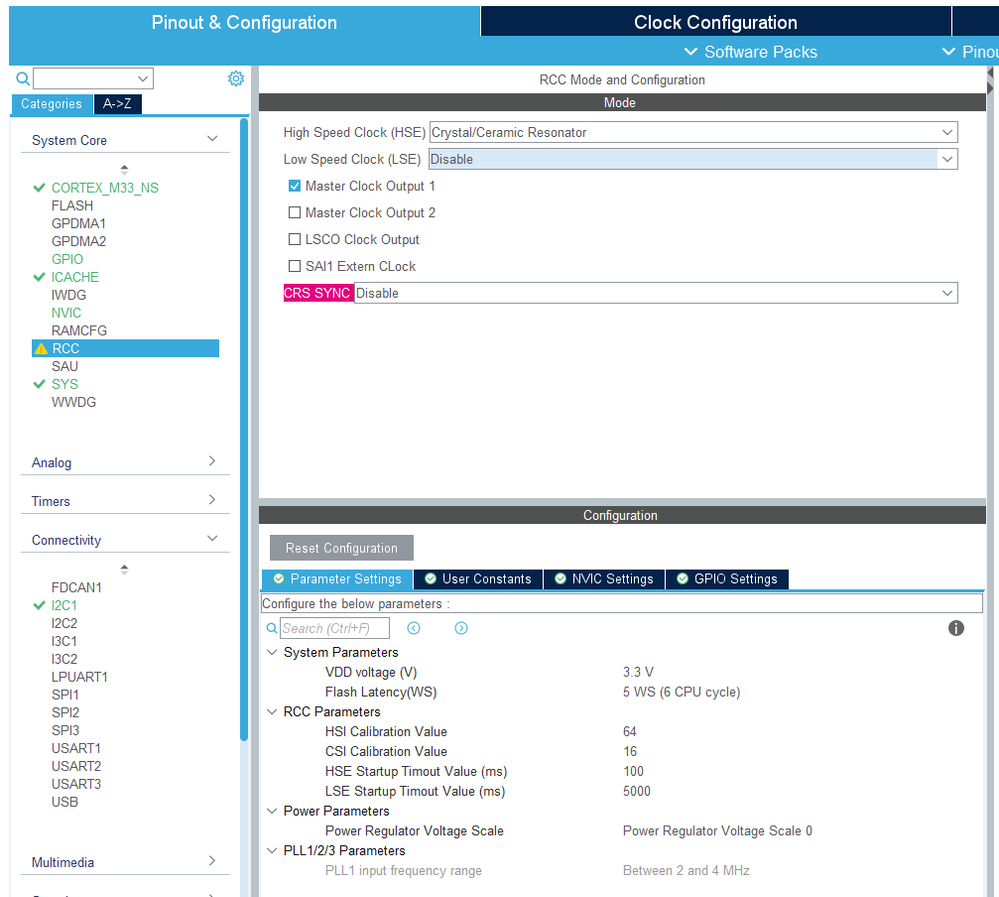

I anyone would like to reproduce it, it is very easy to reproduce.
Build a project in CubeMX for the Nucleo-h503RB board.
NOTE: You have to manually set the pin drive strength to VERY_HIGH because CubeMX will default it to LOW.

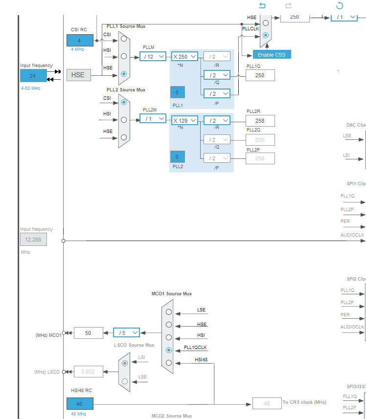

Configure the clock tree as follows:
You will get no output on MCO1 (PA8 which is pin D7 on the Arduino connector on that Nucleo board).
Now, re-test, changing the MCO1 clock source to any of the other choices and you will get the expected output.  Try changing to using different dividers and same results--no output with PLL1 but works with the others.  (I tried all the way to /15 which is the max for MCO1).

- The STM32H503 in LQPF48 packages does not have MCO2 available, only MCO1. Why does the screenshot for the RCC peripheral show MCO2 as being available?

The "simple" repro I did above (screenshots) was with the Nucleo board, which does NOT have the LQFP48 package (so it does have the MCO2 pin).  I did that because it's easier for people in the forum to repro with that than with an LQFP48 which has no Nucleo board available.  I confirmed that the same problem exists with both chip packages.
I have the CPU being driven by PLL1 so I know that the PLL is operating (or it would lock up)
I'm using CubeMX 6.12.0 with H5 HAL 1.2.0 (both of these are the most current available).  I also tried H5 HAL 1.1.1 (the previous version) and had the same results.
Just to rule out the HAL and CubeMX entirely, I also tried the same test by manually setting all necessary registers (no HAL) and the results are the same.  And I confirmed again, that even when I did everything manually, but driving MCO1 from the other sources instead of PLL1, it worked fine.
Using the Nucleo board (because it's more handy at the moment) I just tested using HSI as the PLL1 source (with PLL1M set to 40 and keeping everything else the same so the CPU clock stays within range).  Still no output on MCO1 if it is sourced from PLL1Q.
