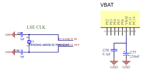

What is the expected RTC peripheral behavior through power cycles on VDD? We have a 3.3V system design with the STM32H562VGT6 right now.
Setup:
  • VDD = 3.3V from external supply
  • VBAT = 220mF supercap attached
  • RTC is enabled & counting, system is stable
  • LSE oscillation is active on the PC14/15 lines
Action:
  1. VDD = 0V for 1-2 sec (unplugged PSU)
  2. VDD = 3.3V restored (reconnected PSU)
Expected Behavior Through Power-Cycle:
  • RTC count maintains operation & counting (count increases)
  • LSE signal is oscillating at PC14/15 lines
Observed:
  • RTC count freezes when power is removed & resumes counting when power is restored
Is this expected? Is it possible to keep the RTC counter active & counting through power cycles?

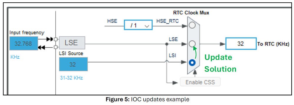

Thank you for the detail and patience @STOne-32@unsigned_char_array, we were able to resolve the situation! Our project was using the LSI within the MSP -
Solution:
void HAL_RTC_MspInit(RTC_HandleTypeDef* hrtc) { RCC_PeriphCLKInitTypeDef PeriphClkInitStruct = {0}; if(hrtc->Instance==RTC) { /** Initializes the peripherals clock */ PeriphClkInitStruct.PeriphClockSelection = RCC_PERIPHCLK_RTC; PeriphClkInitStruct.RTCClockSelection = RCC_RTCCLKSOURCE_LSE; // <- Originally 'RCC_RTCCLKSOURCE_LSI' if (HAL_RCCEx_PeriphCLKConfig(&PeriphClkInitStruct) != HAL_OK) { Error_Handler(); } /* Peripheral clock enable */ __HAL_RCC_RTC_ENABLE(); __HAL_RCC_RTCAPB_CLK_ENABLE(); } }
 Our IOC file wasn't in-sync with our project; is it supposed to be? Here was the update to apply with the IOC -
Thank you guys!

This is not expected and is strange behavior , VBAT mode is used exactly for such use cases where we loose main VDD and keep the RTC counting and LSE Oscillation stable . To debug this case, we need to see schematics of power supplies including VBAT , try to monitor the PC13 output of the LSE/Div and see what happens using an oscilloscope probes while probing the VDD supply and PC13 output. As well as the Firmware sequence.
Hope it helps you .

Hi STOne-32, here is our problem in further detail. -
Target:
  • RTC for continuous operation & counts through Vdd power cycles
Circuit:

I don't see an external charging circuit. Have you enabled internal charging in software?
Reference manual:
VBAT battery charging When VDD is present, it is possible to charge the external battery on VBAT through an internal resistance. The VBAT charging is done either through a 5 or a 1.5 kΩ resistor, depending upon the VBRS bit value in the PWR_BDCR register. The battery charging is enabled by setting VBE bit in the PWR_BDCR register. It is automatically disabled in V BAT mode
If you have enabled charging, what is the voltage on the VBAT pin?
RC-time constant if you use 1500Ohm and 0.22F is 330 seconds. I don't know what voltage the RTC needs so it could be even longer than this. I would use an external charging circuit (a diode with a series resistor should suffice).
