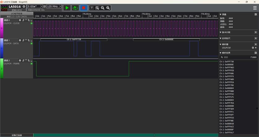

Subject: STM32H563RIT6 I2S1 Not Receiving Data from PCM1804 in Slave Mode (Polled)
Description:
I'm using an STM32H563RIT6 MCU with an 8 MHz external crystal. The I2S1 peripheral is configured in slave mode (receive only) and connected to a PCM1804 ADC chip, which is set as the I2S master (transmit only). The PCM1804 outputs audio in the following format: 32 kHz sampling rate, stereo, 24-bit data packed in a 32-bit frame. Using a logic analyzer, I confirmed that the I2S signals from the PCM1804 (I2S_WS, I2S_BCK, I2S_SDO) are correct and properly aligned. The connections are as follows:
  • I2S_WS → PA4
  • I2S_BCK → PA5
  • I2S_SDO → PA6
I'm testing I2S data reception with the simplest polling-based code, but the STM32H563RIT6 fails to receive data correctly. During debugging in the Start_I2S1_Polling function, the temp_buffer array (used in HAL_I2S_Receive) contains all zeros, which does not match the data captured by the logic analyzer. Below is my code. Could you help identify what I'm doing wrong? Thank you!

Additional Notes:
  • The logic analyzer confirms that the PCM1804's I2S signals are correct.
  • The STM32H563 is in slave mode, so it should not require precise clock configuration for I2S1 since the PCM1804 provides the clock signals.
  • The HAL_I2S_Receive function does not return an error (it returns HAL_OK), but the received data in temp_buffer is all zeros.
  • I'm using J-Link with the latest software (V8.78) for debugging, and the MCU is correctly recognized.
Can someone point out what might be causing the STM32H563 to fail to receive the I2S data? Are there issues with my I2S configuration, GPIO setup, or something else? Any help is greatly appreciated!
