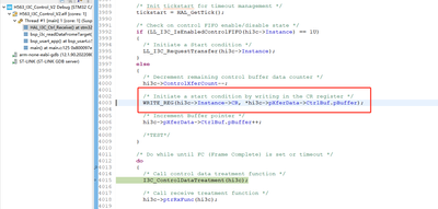

Sunwaz
When the controller send this command, the target will report HAL_I3C_ERROR_DOVER code.
And when the dynamic address of the target does not match,it will not respond to this command.
