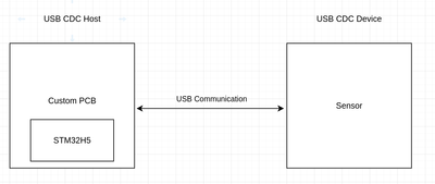

Maybe this picture makes it more clear what I mean and how it should work.
If I connect the same sensor to my laptop it works. In that case the USB Host would be my laptop.
If I would add the captured data, you would see a working connection between my laptop and the sensor, of which we already know that it works. Or is there something else your looking for in the captured data?
