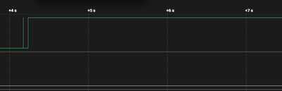

Here's a scope plot of the outputs. The top trace is PB6; the bottom, PA10. Note the runt at the start of the PB6 trace, another issue mentioned in the thread I linked (the solution of which did not work for me).
What am I missing?

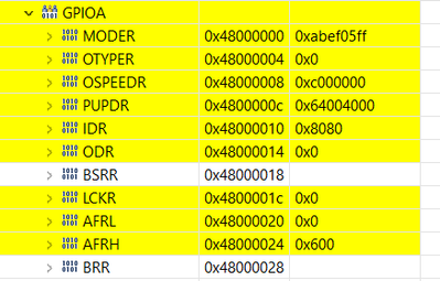

‎2024-01-31 3:04 AM

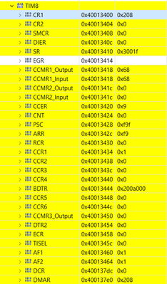

Read out and check/post content of TIM and relevant GPIO registers.
sConfigOC.Pulse = 1;
Is your hardware capable of capturing/displaying such short pulses?
‎2024-01-31 6:43 AM
Initialize PB6 and PA10 as GPIO outputs and toggle them. Verify on the scope you are connected to these pins.
> HAL_TIM_PWM_ConfigChannel
> HAL_TIM_PWM_Start
Feels like these should be HAL_TIM_OnePulse_ConfigChannel and HAL_TIM_OnePulse_Start instead. Although the example uses the functions you're calling.
Register values would probably clear things up.

‎2024-01-31 10:22 AM
Note: The complete lack of output on PB6 was due to an unnoticed solder bridge. Now both channels exhibit identical, incorrect behavior (a runt followed by a step as shown in the original picture).
Since both outputs are now behaving identically, I believe it is safe to focus on one setup, TIM8/PA10
sConfigOC.Pulse = 1;Is your hardware capable of capturing/displaying such short pulses?
Yes, and did you look at the trace I showed? The outputs go high and stay high after the runt pulse. It should never do that. One "pulse" should be idle low, active high, back to idle low.

Mentioned in my reply to jan, but yes; simply leaving the OPM bit unset yields a PWM pulse train that follows the expected timing set in Pulse (CCRx) and Period (ARR).
The critical problem here is the return to high output state after the pulse. This pulse serves as a trigger to an optical sensing device, which is level sensitive rather than edge sensitive; the line must idle low for proper operation.

You have TIMx_CCMR1=0x68, which means OC1M=0b0110 i.e. PWM mode 1. From RM:
PWM mode 1 - In upcounting, channel 1 is active as long as TIMx_CNT<TIMx_CCR1
else inactive.
This means, that in idle, when TIMx_CNT=0, it's <TIMx_CCR i.e. output is active, i.e. 1.
‎2024-02-01 10:12 AM
@waclawek.jan wrote:This means, that in idle, when TIMx_CNT=0, it's <TIMx_CCR i.e. output is active, i.e. 1.
Okay, that sort of makes sense, but then why does the line start out low before the timer is started for the first time?
Switching to PWM Mode 2 gives me a pulse like I expect, but only once. If the CNT is being reset to 0 (and it must be, because that's what's making the line idle high in PWM1), what else am I missing to get it to generate another pulse when setting CEN = 1 again?
Still using the main() code as quoted in the original post; I would expect to see a pulse come out each line every two seconds, staggered by a second. But there's only one.
... oh. It's what I would call a design flaw of the HAL code. The software knowledge of whether the channel is busy doesn't get set back to "ready" after the pulse, so the next call to HAL_TIM_PWM_Start returns an error. If, instead of calling that method, I do the things that method does (namely, set CCER enable bit for the proper channel, set MOE bit in BDTR, and set CR1.CEN), then I get another pulse.
So I have something that works now. Hearty thank you for everyone's input; it all has been helpful in getting me to the right answer.
