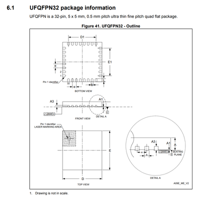

I can't see exposed die pads on STM32G491KCU6 and KEU6. Is this okay to use? Are they thermally limited for use?

Yes, we confirm that no exposed die pad on this selected package and MCU, You see our datasheet here :
STM32G491KC - Mainstream Arm Cortex-M4 MCU 170 MHz with 256 Kbytes of Flash memory, Math Accelerator, High Analog level integration - STMicroelectronics
We need to ensure that the Junction temperature should stay below Tjmax so in your selected package U6 that means 105°C in Low power dissipation and up to 85° in maximum power dissipation.   and many thanks to spot this case as It draw our attention that in Table 102 the Package thermal characteristics  for QFPN32 are missing :
Thermal resistance junction-ambient and is 91°C/W
Thermal resistance junction-case is 30.5°C/W
Thermal resistance junction-board is 37.5°C/W
to be able to so your own simulation.  We logged this in our Internal Database with Number 169990 for follow-up.

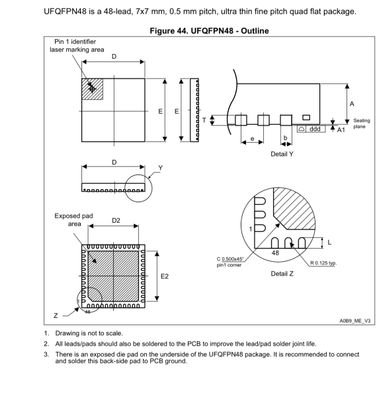

Any reason why this doesn't follow standard QFN32 package with die pad?
From STMicro e-store, the die pad is shown on KEU6 and not on KCU6 footprint.
Dear @MallikarjunSE ,
You can select instead the QFN48 package that have the best thermal performance where you can see the exposed pad in the 7*7 mm surface . However the part number is C and not K .
I need to check this data  on the estore which is not inline with the product datasheet .
I’m not sure that there is a standard on exposed pad on package , it depends on many parameters - feasibility and also target applications and market versus all packages .
